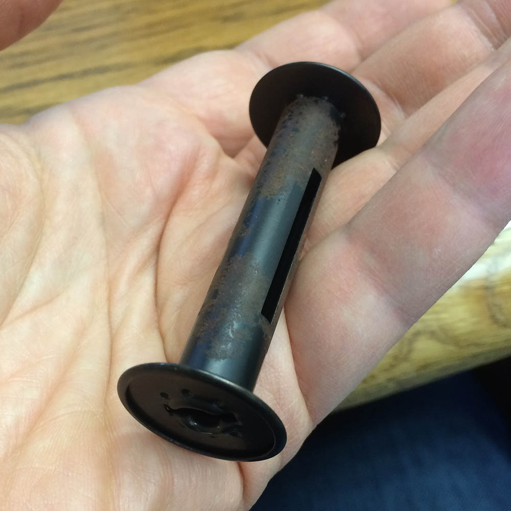

I got an exposed roll of Ansco "All Weather" 120 film out of a recently purchased Yashica C circa 1957-1958.
The roll has black paper backing, not the usual silver one (see the pictures below).
The spool is metal and somewhat rusty (the camera itself is rust-free but clearly not used in possibly decades).

Note to myself:
HC-110, Dilution H, 20 min @ 68F.
Despite very bad fogging I got fairly recognizable frames with this recipe.
