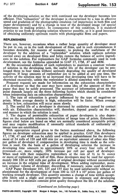

Here's a copy of a page from an old Photo Lab Index page on GAF developers.
