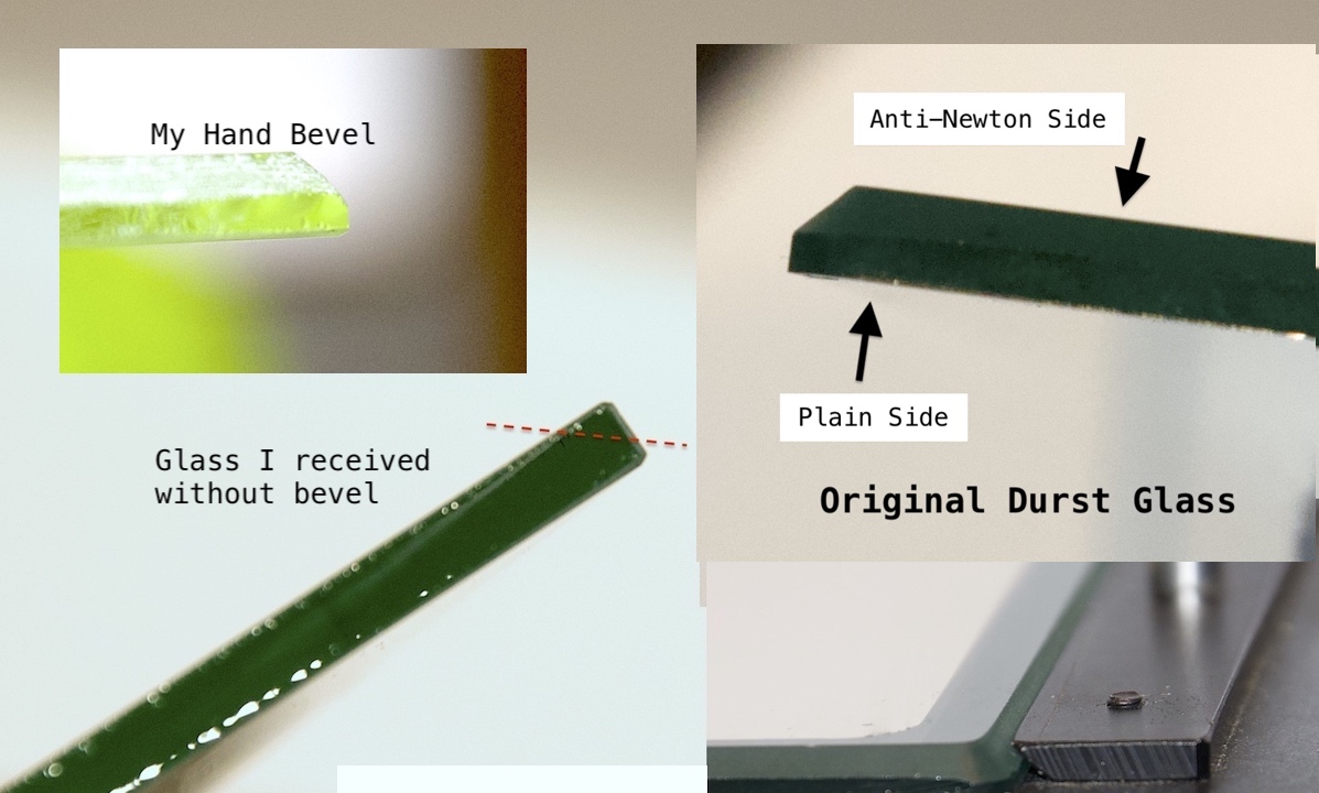

I did contact Knight Optical and was able to order from them as below.
I wasn't very happy with them. I sent them pictures of the original Durst glass so they could taper the edge. The glass itslef was nice but apparently they were unable to taper the edge so it would fit in the negative carrier. I thought that was crazy that I had to taper the glass myself. What glass company can't taper the edge of the glass??
When I tried to send it back they indicated I agreed to the "protective chamfer on edges" on the quote, which I thought was their description of the bevel in the picture I sent them.
In the end I got my glass, but what an expensive and time consuming headache!

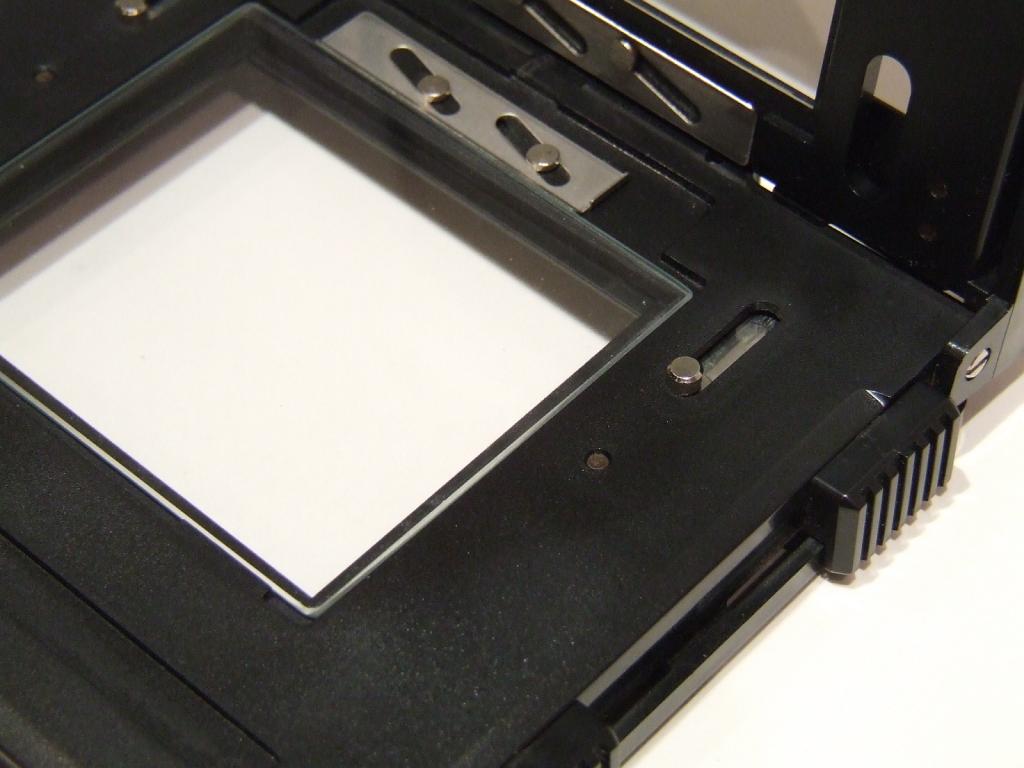

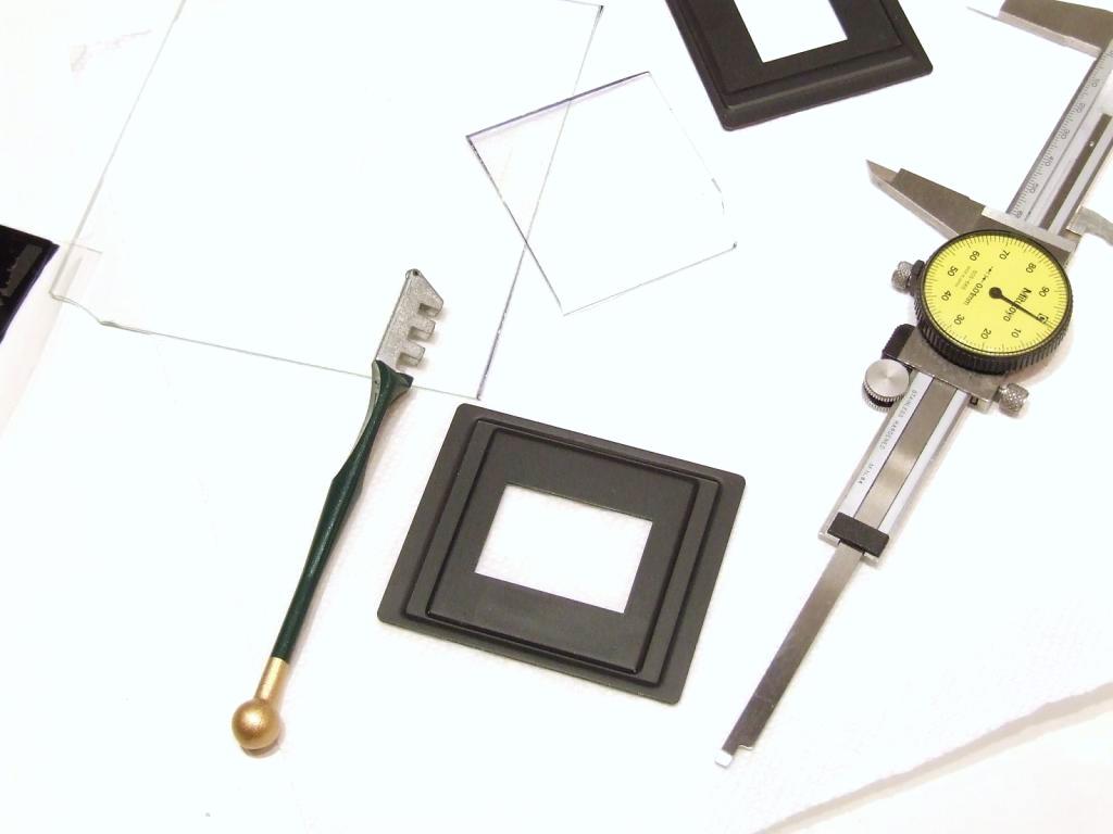

I cut this 6x7cm glass from a broken 4x5" piece of Durst AN glass. I used a regular glass cutter and beveled the edges under running water with wet sandpaper. Be careful not to scratch the surface.

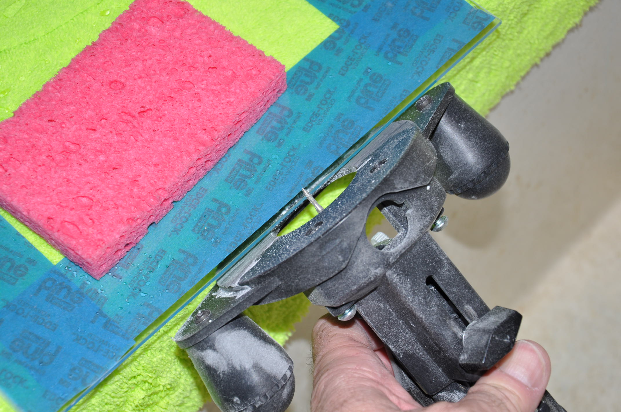

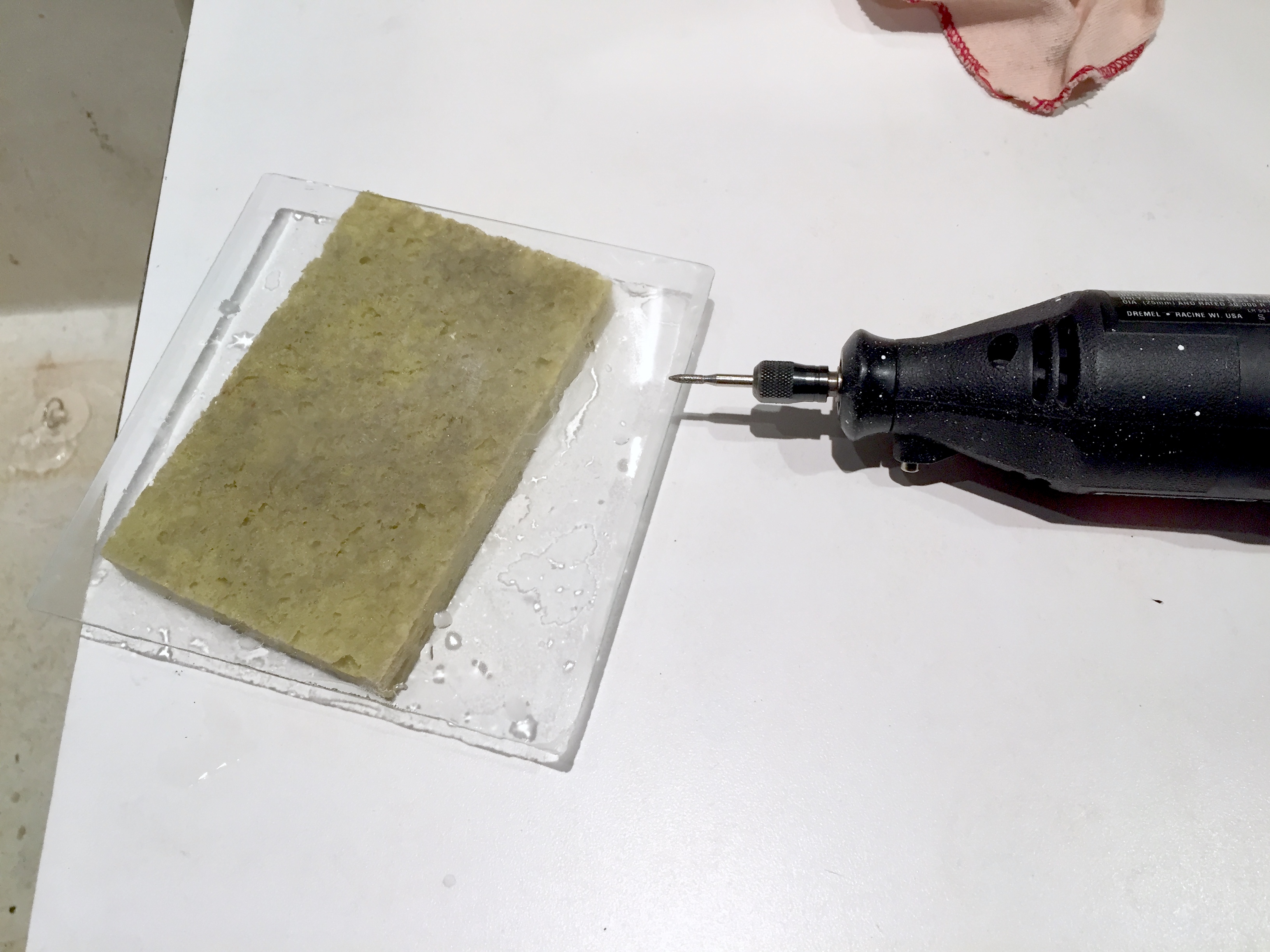

I also cut down a broken 5x7" piece of Durst AN glass to 4x5" for my Omega. This one needed more of a bevel, so I used the diamond bit of a hand motor tool. The sponge and water are for dust control and to keep it from getting hot and cracking. If you go slow, it does not really get hot.
