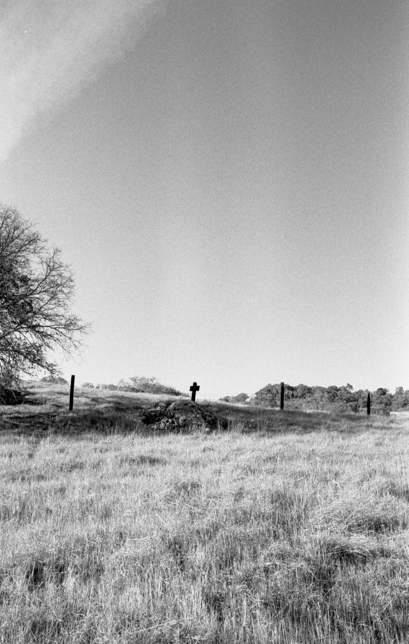

I understand that it happened with different lens and camera combinations, and in different locations.
But if you find yourself drawn to particular types of lighting, perhaps that is the commonality.
Or perhaps you like to photograph wearing really bright hats :D.
Well, that's something I hadn't considered. These photos were shot in very harsh midday light, and I do often wear a white Adidas tennis hat when I'm shooting in those conditions :D. If that's somehow related that would be pretty funny :smile:

Well, my latest roll contains two frames that exhibit the same two high-density bands down the center of the frame. As before, both frames are in portrait orientation. I'm pretty sure I remembered to remove my hat before I shot them :smile: Oh, and this was with a different camera than the last two rolls.
Film is still 35mm Tri-X 400.
I'm at a loss to explain it...

If it were bromide drag, it's going the wrong way for 35mm in a small tank. I think Matt is probably onto something with the internal light reflection thing. I don't know where it could be coming from, but it's possibly coming from the shutter box, back of the mirror when up or the rear of the lens itself. I'd work on one thing at a time. Try drying horizontal first, then go after a light reflection thing. He'll narrow it down. JohnW
Theres also the possibility of bromide drag, especially considering you were using a fairly dilute developer. Its possible your agitation technique is not aggressive enough to move the exhausted developer away from the film quickly enough. As a result the shadow areas with less development have stronger developer next to it and this gets moved into adjacent areas to make the darker streaks. This can happen when the tank is filled full enough theres very little air in it and these bubbles pushing thier way up as the tank is inverted help increase agitation.
I don't know much about the causes of Bromide drag, but the photos of negatives I've seen that are supposedly affected by it always seem to have the streaks running in the other direction. I'll try a slightly more vigorous agitation method on the next roll and see if that cures it.
That's what I thought as well.
Well, this has now happened with three different camera bodies/lenses so I'm not sure how that's possible.
Whoops! I missed the three different bodies. Well, then it does look like it might be a drying error. You should probably start there and try some of the recommendations. Let us know what you find out. JohnW
I'll look into the possibility of a drying problem and try some of the recommendations. Thanks.
One more issue that has affected a couple of negatives: Dark circular areas in the sky, one per frame. These two scans are from adjacent frames, but there is one other frame that is affected on a different part of the roll. These spots are very difficult to see on the negatives but if I look very closely I do see areas that appear to have reduced density where these 'blobs' occur.
These seem too large to be air bells and I'm pretty careful to rap the tank on a hard surface after every agitation cycle. I also figured I would have more than one per frame if air bells were the cause and it seems too coincidental that they'd be in almost the exact same place in the two frames. I also thought maybe drying marks, but I don't see them when examining the negatives and I thought drying marks would look like lighter areas in scans. I'm washing my negatives using the Ilford method and doing the final rinse with distilled water and a few drops of Photoflo. I do have very hard water in my area, so perhaps I should mix my chemistry and perform all wash steps with distilled water.
Interestingly enough, the first few rolls of film I developed had no such spots and I used 3 drops of Photoflo in my 2-reel tank. For this roll, I decided to cut back to 2 drops since I was getting a lot of bubbling during the final rinse. I'd be surprised if using one less drop would cause this, but who knows. In any case, I re-washed the film just to be sure and there appears to be a bit of improvement (see 3rd scan), but the scans look a bit different despite me not modifying the raw scans at all.

Here's a rescan of the second negative after re-washing:
That looks an absolute pain to fix
It's not drag or surge marks as it only happens in portrait
It doesn't look like drying marks to me
The development regime looks correct.
Happens with multiple bodies
One reel in two reel tank with empty reel on top.
Be interested to know how this is resolved
When I see the last batch of examples, the first thing I think of is Edvard Munch ......
Fingerprints?
I'm very careful to avoid touching the film while I load it on the reel and I'd be surprised if I touched it in nearly the same place on three different frames if I did, but I'm baffled - again.
I've rewashed the film multiple times with very little perceptible change.
