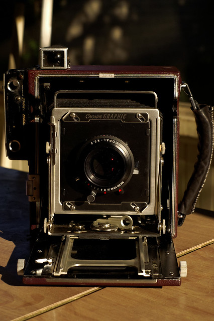

So I ended up getting a Crown Graphic set-up. As It cames with a Caltar II-N 135mm f5.6 in a Copal #0 shutter, 4 Fidelity Elite film holders and 4 boxed of expired 4x5 film (Agfapan APX 100, Ilford Delta 100, Ilford FP4, and Kodak Plus-X Pan). Now The fun part starts.

Congratulations. Shoot with that lens and learn if you like 4x5.
If you end up liking the Crown and want a longer lens then I'll let you in on a little secret. Rodenstock made a lens called the Geronar 210mm f/6.8. They also made a Caltar version. They are great little inexpensive lenses that are short enough to just barely fold up inside a Crown Graphic. A 135mm and a 210mm make a nice pairing!
