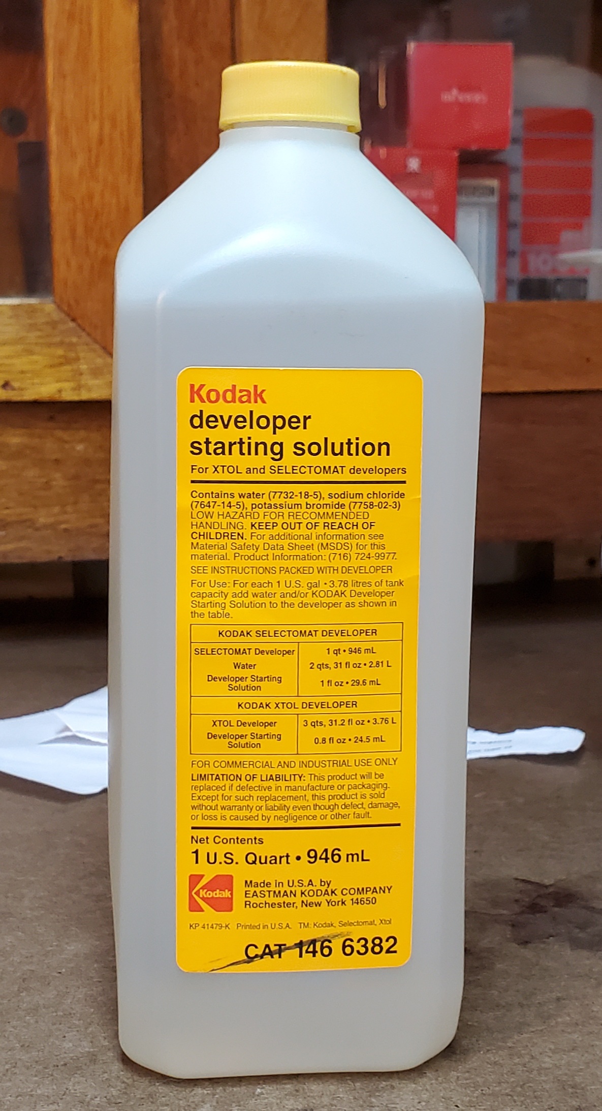

Kodak has never, AFAIK, offered a starter for Xtol (giving seasoning instructions instead),
This is at least 15 years old.

Kodak has never, AFAIK, offered a starter for Xtol (giving seasoning instructions instead), but they have, over time, for a number of other replenished developers (including Flexicolor, which is kind of the gold standard here aside from Xtol -- replenisher plus starter to make a new tank solution, and in LORR format, 25-35 ml per roll depending on exact format and emulsion type, capable of running for multiple years and tens thousands of rolls in a 5L solution batch).
The X-Tol instructions describe how to use a variety of different starters, as follows:
You can also “pre-season” fresh XTOL Developer
by adding one of the following:
• 6.5 mL of KODAK Developer Starting Solution
(CAT 146 6382) per litre of developer
• 1 mL of KODAK EKTACHROME R-3 First Developer II
Starter (CAT 869 9795 [U.S. and Australia] or
CAT 524 0007 [Europe]) per litre of XTOL Developer
• 1.2 mL of KODAK PROFESSIONAL First Developer
Starter, Process E-6 (CAT 167 1577 [U.S.] or CAT
526 2670 [Europe and Asia]) per litre of developer
