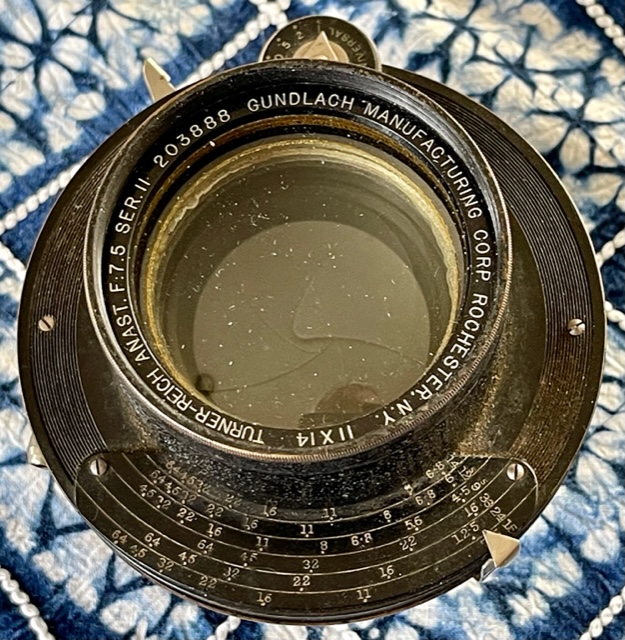

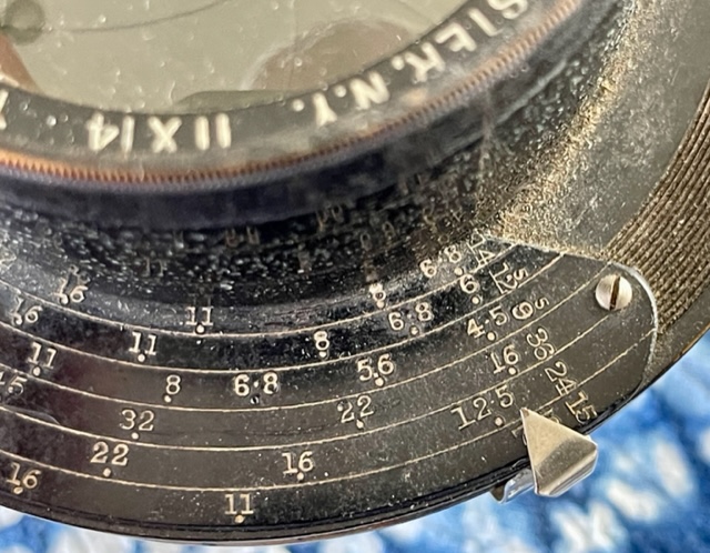

The standard 11X14 TR is present and in fine usable shape, but the main reason I bought it was because of the other scales on the aperture plate.
So! What is the mystery cell set that would be 9.5" combined at f4.5! 12.5" single at f6, and 14" at f6.8. My first thought was that this would have been a casket set that included a Hyperion Diffusion which is in fact a triple convertible also. But after consulting the Gundlach Cat. there is of course no such animal. 9" f4 - has 15" and 21" components. Plus they are f4 combined, not f4.5. The single f4.5 lens from Gundy is the Radar but it is not a convertible.

My dear bride (of 47 years) had a hen party tonight (on valentines day no less!!) and I was banished to the workshop, so I serviced and cla'd the shutter and carefully cleaned the glass surfaces with alcohol and this old lens is ready to ROAR again. 15 is a great length for me on 8X10 as I quickly found back as a learner that a 210 on 4X5 saw much closer to my vision than a 150.

Yes, the cells present are the easy ones. Very common 11X14 #6 size Series II Turner Reich lens of 15" - 24" - 36". Also used with #16 Cirkut cameras.
And the shutter is the fore-runner to the common Ilex #4. Sir Steven Grimes.gave the early Ilex shutters a bad reputation but compared to other primitive shutters of the same era I find them very usable. The 1922 catalog advertises this lens in the Acme Universal shutter at $177 which with the inflation calculator becomes; $2839.27! Anyone want it for half the 2021 price?

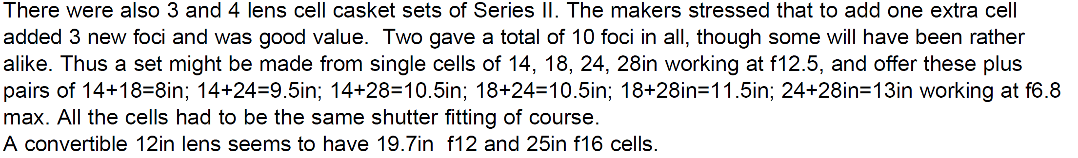

24 rear + 36 front = 15 f7.7

Gundlach sold it as an f7.5 combination. 24" is f12.5 alone and 35" is f16. Gundlach was pretty loosey goosey with all of their numbers. Everything is approximate. I have no resource to measure actual anything beyond what the aperture dial states. No the two cells cannot mount to each other if that's what you mean. My guess is that this item was a factory special order by someone who had some other lenses they liked and sent them to the factory to be incorporated into a sort of vade mecum set with this shutter and the Gundlach cells. The f 4.5 value at 9.5 inch is limiting. Maybe they had a particularly favored Petzval they wanted to use in the same shutter. 9.5 f4.5 is plausible for a Petzval, and rear group alone would be maybe 14" f6.8. I'm just making stuff up. Since all that remains is the TR I suppose we'll never really know.

So the scales do not match the cells f number if rear mounted.
