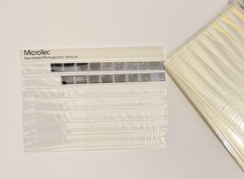

And now: how do people store their Minox negatives these days? AFAIK no one is still making the old negative wallets. I think I could improvise something with zipper bags and a heat sealer, but it would be a lot easier to buy something if it's available.
xya
Jun 13, 2010
1,058
Calais, Köln
I just cut them and put them into 35mm sheets. Like I do with the 110 film strips. You can put 2 films per sheet or even 3 for shorter Minox film.
Donald Qualls
Donald Qualls
Jan 19, 2005
12,445
North Carolina
Hmm. With the old standard of ten Minox frames per strip, and a few minutes with a heat sealer (to modify half a dozen negative pages) I could put four Minox rolls of up to 50 frames in a single 35 mm page -- by dividing each negative sleeve into two horizontally, and again vertically. Might work...
