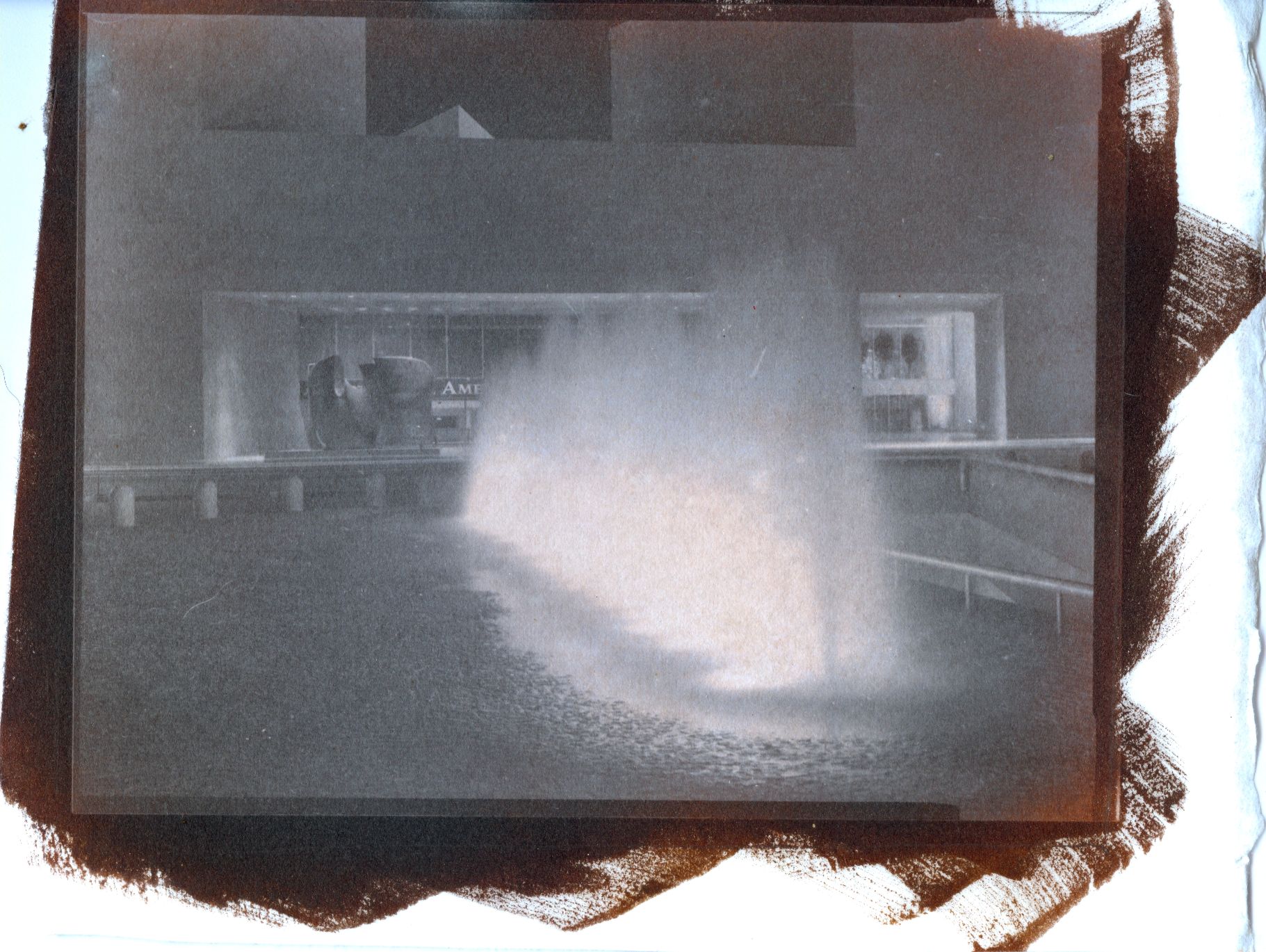

Electrumtype Kary Sample: Fountain, Natl Gallery Art, DC
Here is a promised Electrumtype Kary. This one was printed on Arches Platine using the ammonium ferric ferrous oxalate: 1 drop Au, 5 drops AFFO. I suspect the over-brushed area is reddish-brown, rather than purple, because I used a fairly old scrap of Platine, one leftover from last October. Not sure how the image resizes or if it does. It is a 4x5 scanned at 300 dpi. Minimal reworking, just enough to reverse my HP G4050 scanner's mauling of the image.

Could it be a result of the ammonium ferric ferrous oxalate instead of the old platinum. Iron does rust :smile:
I actually quiet like the split tone you've got and think that it might work quiet well for some subjects/objects
Again thank you for sharing

There's no platinum in the formula -- I gather you misread, for Arches Platine is a hot pressed 310 gsm rag cotton paper, not a metal salt. Arches Platine is superb for printing gold (and platinum and palladium -- though I prefer Revere Platinum for those two metals). And the reddish-brown tone at the edges is not in any way a result of oxidized ammonium ferric ferrous oxalate. Gold behaves rather differently from platinum and palladium as regards color: the color gold exhibits varies depending on the humidity / moisture in the sensitizer at the time the sensitizer is exposed to UVB light. The edges show a different color because the sensitizer is brushed on more lightly at the edges than in the center and middle areas of the print. As a result, the sensitizer at the extreme edges dried further (during the 15-20 minute dry down in the dark) than did the sensitizer at the middle and center. If I wanted to minimize the split tone, I could tape off the edges and eliminate the overbrushing, and take greater care to brush the sensitizer evenly across the entire image area. Alternatively, I could just let the whole thing dry longer -- half an hour or so -- and that would also minimize split toning.
But as I noted in my post, the Arches Platine was old -- I bought it last October to use for my presentation at the APIS in Santa Fe. The sheet was a roughly 10"x7" scrap in a pile of paper scraps on a shelf. I would have discarded it except that it was the last Arches Platine I had on hand. I was delighted when the gold dutifully printed out (without looking like a chrysotype s print -- except at the extreme edges).
