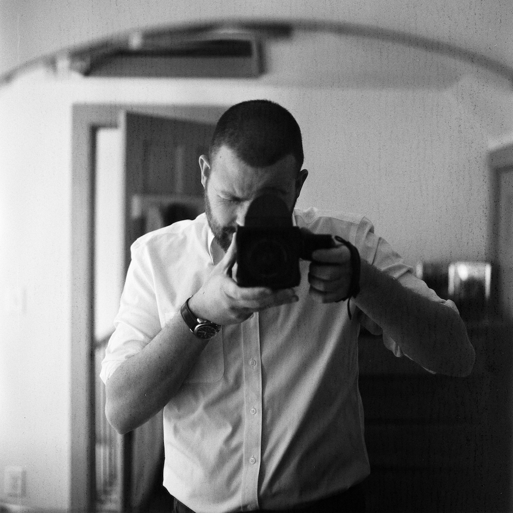

I shot my wedding myself last week. It was a tiny little ceremony with the neighbors in very Covid style. I decided to do all B&W so I could print the images in my darkroom. I shot 3 rolls of FP4 35mm and 5 rolls of Bergger Pancro 400 in 120. Well, all the Pancro shots have backing paper mottling.
I think I can still print the images and enjoy them for what they are, but this is still unacceptable.
These were fresh rolls, stored properly. It's all in date stuff that I bought earlier this year at Catlabs. I kept them in the fridge, but in their box and packaging. This just should not have happened.
Has anyone gotten replacement rolls from Ilford or Bergger? I contacted them via their website.
P.S. I processed the film in Bergger Superfine. Very interesting developer! You must run the film at 74F, and you are to rate all films at half speed. I actually kind of like the results with the FP4 that doesn't have mottling, and with the less severely effected Pancro shots.
Honestly, that shot looks like an effect I've seen intentionally generated at premium cost. Ever heard of "washi film"? It's 35mm coated on Japanese bamboo paper, and the paper fibers inevitably show in all scans and optical prints. And it's, as I recall, something like $35/roll.
You got virtually the same look for the regular Bergger Panchro price. :angel:

The mottling effect was known in the industry, but always related to extreme humid storing conditions. But the cases of today are typically cases where the photographers claim to have used fresh film under normal conditions and directly processed.
Yeah I don’t know how to make it more clear. This is in date film recently purchased. I stored it in the fridge until a few days before the event. It was still in the box, in the foil. I shot it on a 70 degree day and processed the film today in a conventional developer in my Jobo.

Again, I shot a roll from this batch that was NEVER in the fridge and it had mottling. This. Is. A. Manufacturing. Issue.
I've seen it in my customer's rolls, and now I'm seeing it on mine.
