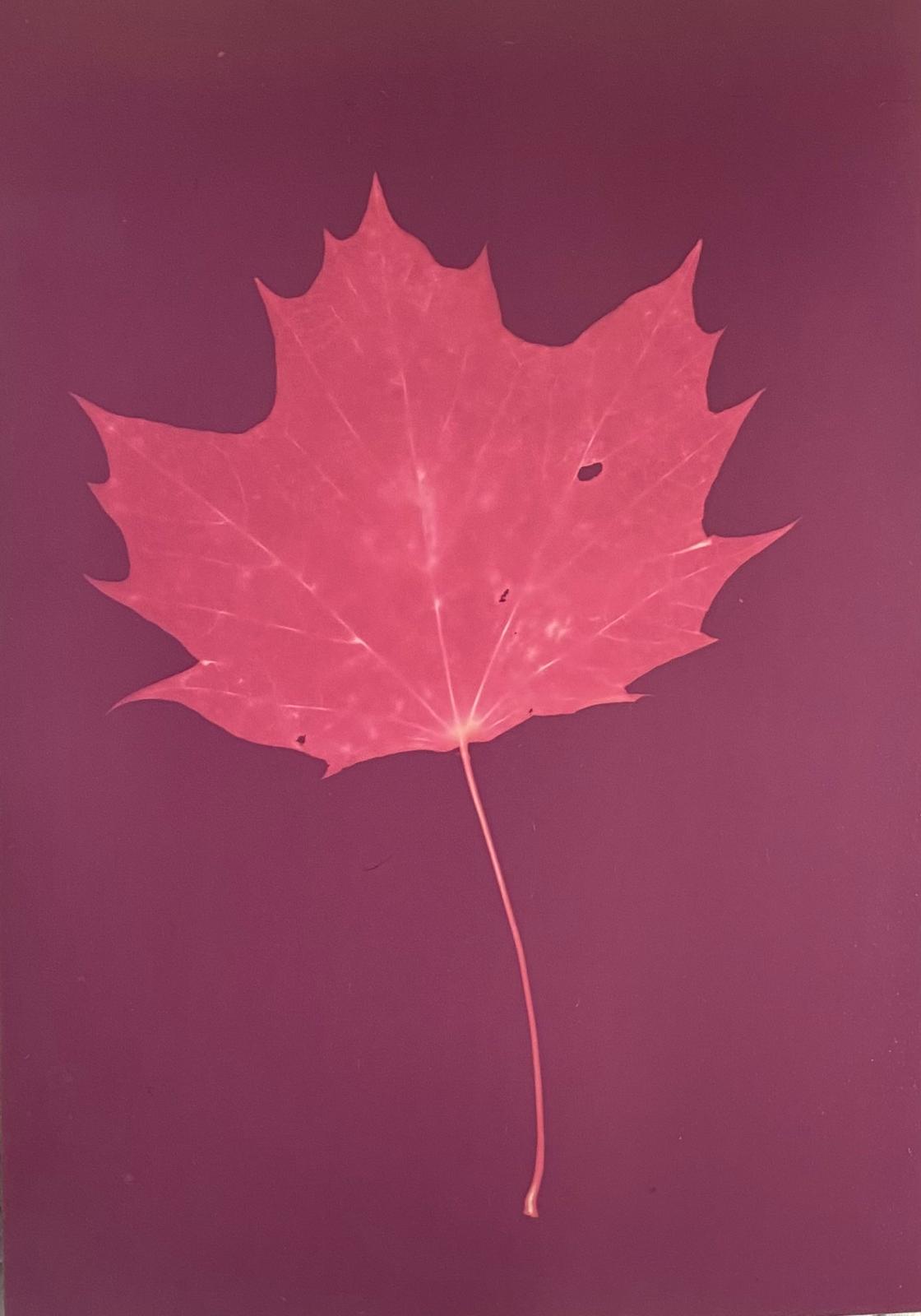

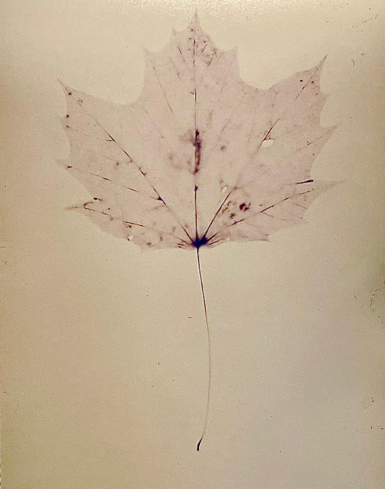

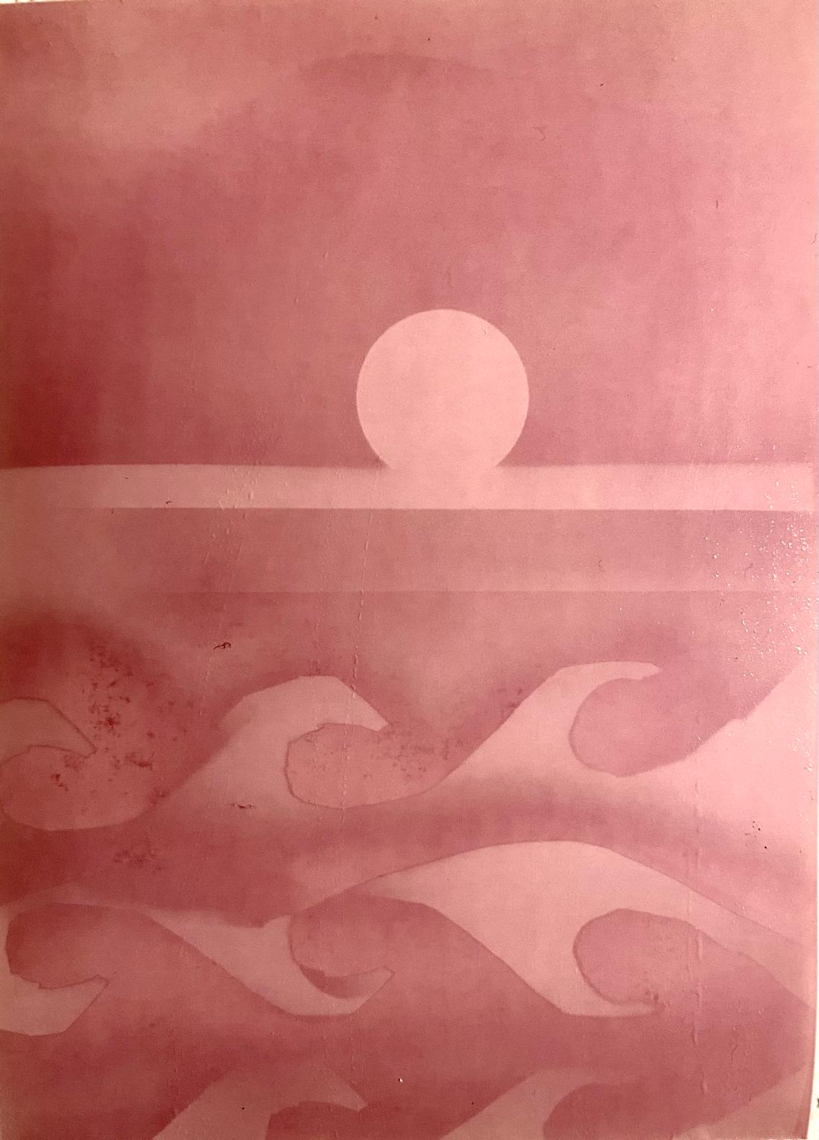

I had bought a while ago a lot with what seller called RA4 paper but it turned out to be EP2 from Labaphot -Labacolor. I can date it to about 1989 or there about. Yesterday and today i had a go with it. It is definitely ok for alt.processes but from what I have read EP2 will get bad on the dye for the yellows. Which I can confirm. I found it responds well to RA4 developer and I also made a direct reversal with it (photo-gram) all this stuff I exposed with an LED flood-light for a fraction of a second at 1.5 meters distance. The papers I have have still very equal development and the whites are a nice chamois.
Left "normal" development with RA4 developer
Right RA4 reversal, first development with Foma Retro320
a new unknown daylight process , using expired C41 developer, exposing with UV-flashlight first. But it does not handle that too well as the UV will almost instantly break-down the last bit of dye couplers.
So now I know, and did not expect that even 35 year old EP2 paper can be used. (sometimes)

Very interesting, thanks for sharing! And those are some lovely results you've gotten there, especially the last one!

thank you for your reply. I had the expired paper standing here for a long time before I was curious enough to play with it. So my conclusion the patient is still alive but not running the mile in full color any longer. For me that is fine for experimenting
