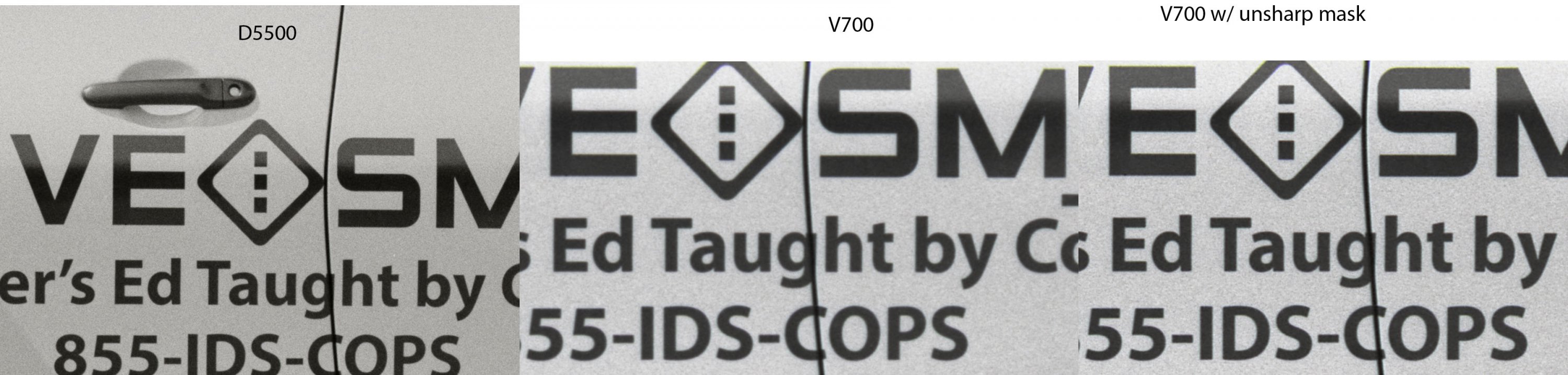

... Scanned by a "biopsy" with DSLR which blows my V700 out of the water. With V700, none of the lenses are distinguishable (this is a lesson in itself).

What is a DSLR biopsy? I dont understand.
Not to derail the thread, but I would like to know what you did rather than scan. My only DSLR is a D700 (12MP full frame); my scanner is a V800 - which is not better than a V700 optically.
P S. That 100mm CF that you no longer like -give it to me.
I used my d5500 with a Nikkor 55 f2.8 at .5:1, mounted on my enlarger's stand to take a picture of a portion of the negative on a light table. The negative is held flat by a mask from my enlarger. If I went to 1:1 it would be even more obviously different but I would start introducing potential issues due to a lack of field flatness of my macro lens at 1:1. This could be alleviated with a better macro lens. I've attached a comparison of the two, and here's an album where you can see the full image: https://imgur.com/a/JiOE5r0.
By the way, if you are serious about buying the 100mm CF, PM me. I don't think it's a bad lens, but I do not think it lives up to the mythology of being the best lens in the Hasselblad system, or to its price, being roughly double that of the 80.
OK, I see how this is done now. You are correct that the DSLR technique yields better results than the scanner. Thank you.
