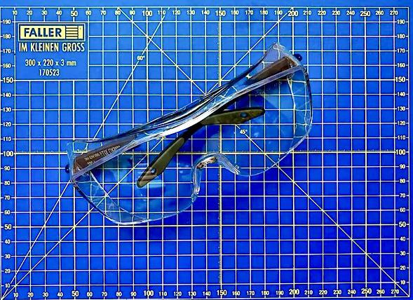

When working on devices, and especially when disassembling springs, you should wear safety glasses. Springs are unpredictable and can spring out, even if you’re careful. You don’t want that to hit your eye.
Safety glasses also keep out parts that you pry out with force and that can fly off unexpectedly.
Even when soldering, safety glasses protect against splattering solder and flux.
Tools can slip and hit your eye if you’re close by. Or you can grab your head with the tool in your hand.
I have personally experienced all of these situations, which is why I consistently wear polycarbonate safety goggles while working—they are also available to wear over prescription glasses.
