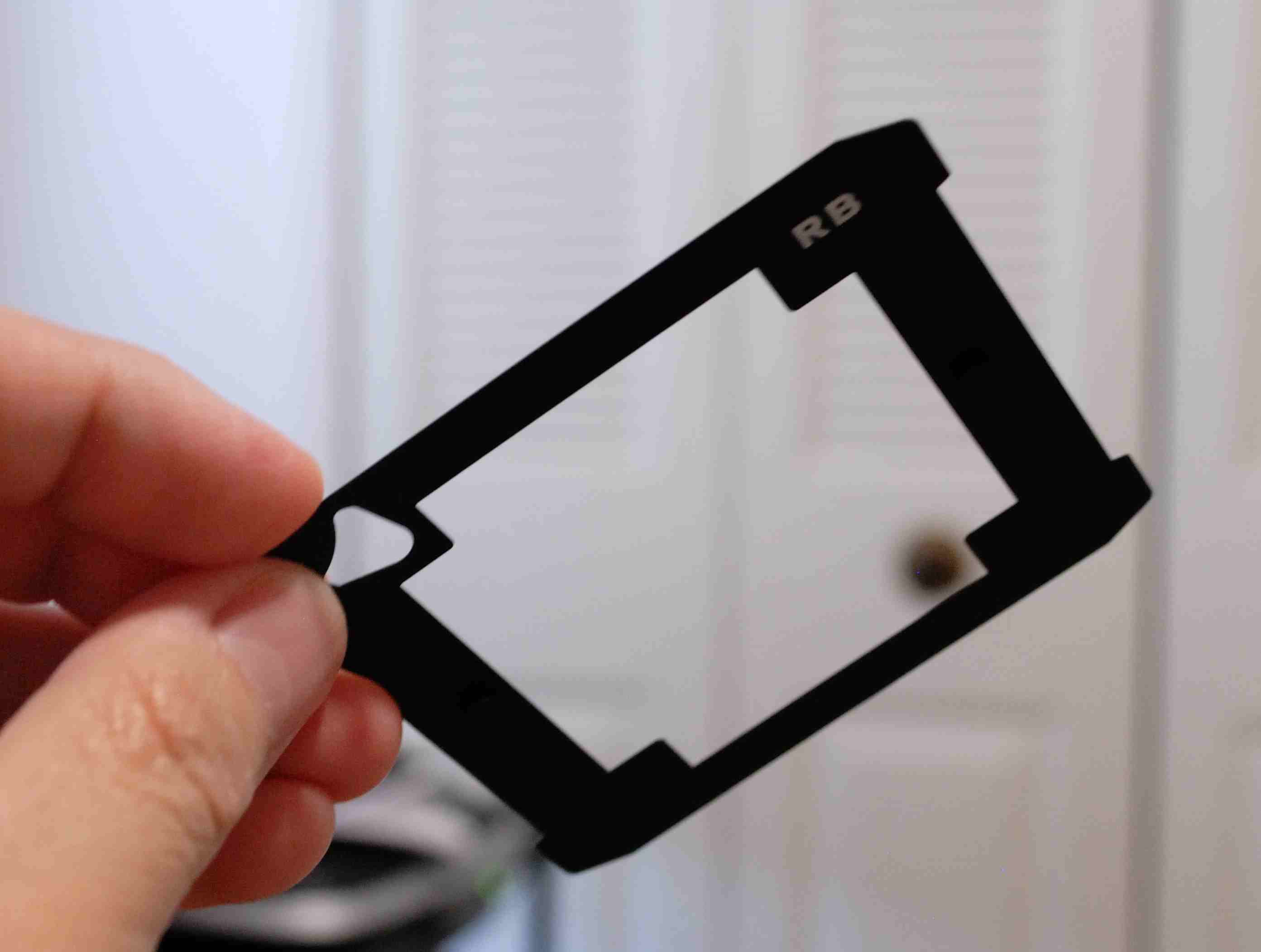

RB series camera bodies were designed as 6x7 camera. For this size, you get a 6x7 back and remove any masks in the view finder if any. When you look into your view finder, do you see a cross looking opening? (picture attached) If so, take off your view finder and remove this thing. Now you'll see the whole film area for 6x7.
You can also get 645 back (the whole back, case and the insert) and this mask.
You can also get 6x6 back (the whole back, case and the insert) and I'm not sure about the mask
Or, you can get 6x8 back. This is a power back that winds electro-mechanically. There are two types, one with integral battery and one with an external battery pack. It is supposed to come with a new focusing screen. If you have an older type body, such as Pro or an older Pro-S without "8" on the body behind the rotating back, you'll need to replace what is called a "buffle". Pro-SD does not need any modification.

I have the RB67 professional S body. That's whats on the back as well. The back rotates from one orientation to another. I don't believe there is any mask under the prism finder and/or WLF. There is a piece of glass that will come out, but I don't think it's a mask. I do see some dotted lines and a red line based on which way the back is turned.

I think you are missing the mask, if that's all you have. You'll just have to be aware, what you see on your view finder isn't what you are going to get on your film. (because film is smaller) I think you did get a pretty decent deals.... You got a lot for $500. I think once you get 6x7 back, you may begin to appreciate the size of the negative.... with 645 back, you really aren't using your camera to its full potential.
