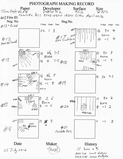

I envy those who are savvy with electronic devices. But I'm not so I have to do things the old way. I keep my hand-annotated darkroom notes on 8x10 paper forms printed out with a cheap laser printer. The notes then go together with the gelatin-silver photographs and the negatives in the same archive box. The part of the creative journey that happens in the darkroom is easy to repeat if I get orders for more photographs. And sometime in the future people I may never meet might be amused at all the fuss. Here's an example of notes and a resultant photograph:
This is my darkroom record for making photographs from a series of negatives including negative #14. This negative will yield the photograph entitled "Twisted Snow Gum, Charlotte Pass.
Gelatin-silver photograph on Ultrafine Silver Eagle VC FB photographic paper, image size 21.2cm X 16.2cm, from a 4x5 Efke IR820 negative exposed in a Tachihara 45GF double extension field view camera fitted with a Schneider Super Angulon 75mm f5.6 lens and IR680 filter.
Titled and signed recto, stamped verso.

My own hand written method is to make notes on a print exposure record like the attached one. I hole punch the paper and file it with the negative sleeve.
That works well for me, because the pile of negatives is growing, and it's near impossible to keep it organized in any other way.
