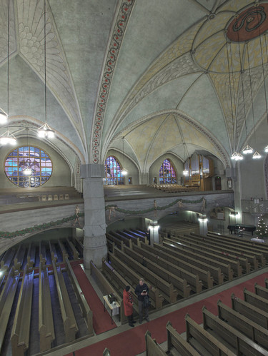

but ok ... here's a go.
I visited a cathedral in Tampere where a famous Finnish artist had done the interior paintings. I love his work and wanted to record the interior of the cathedral.
http://cjeastwd.blogspot.com.au/2009/11/cathedral-at-tampere.html
I wanted to capture the interior subtle lighting and its stained glass and also the sence of the architecture.
I liked the results of applying my technical knowledge to the task so that I cam out with images I was pleased with aesthetically that were not technical failures.
gosh ... I just brought that round to technical stuff again ;-)
