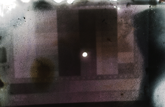

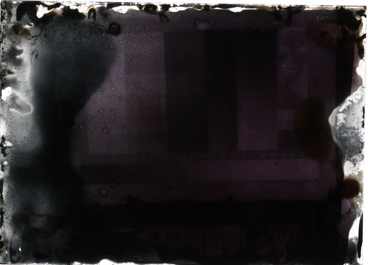

Hi All,
Sorry that I have not participated lately. Here are 2 examples of emulsions containing no gelatin. At risk of sounding like a broken record B&S has a supply of Kuraray R1130, which is what I currently use in place of gelatin.
Cheers Bill
P.S. Sorry if I have posted these befor.
