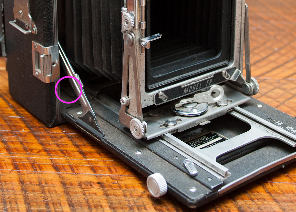

It seems that both back braces for the rails of one of these cameras are broken. I've looked here and online, and unless I missed it I can't seem to find any information on possible replacements (Except to say replacement parts are scarce...). I also am curious how to get around the baffles to unscrew the mounting screws... Ideas?

Wow, that first site is great. I definitely have the Graflok back (same on both). The rails I was talking about are the bellow rails. There is about a 2 inch section of rail all the way in the back that has a metal guide holding it down, the braces are in good shape on one camera, but they are all busted up on the other. Does that make sense? I didn't realize there was a forum on graflex.org; I'm headed there now.

I'm not with the camera right now, but using pictures already up here... It's the 1.5-2" brace that holds the back rail down (on both sides). The little lip that actually does the holding down has been sheared off.

You mean these bits :D
I bought two spares from an online seller and repaired mine, there a couple of people in the US who strip down Pacemaker Graphics for sp[are parts which they post on their own webites or Ebay. One was Canyonland Graphics (lakesgraphic on ebay) and the other just has a website but I can't think of his name off-hand.
Luckily I didn't need to many parts to rebuild two totally written off Speed Graphics but they are getting much more expensive now, so good luck :D
