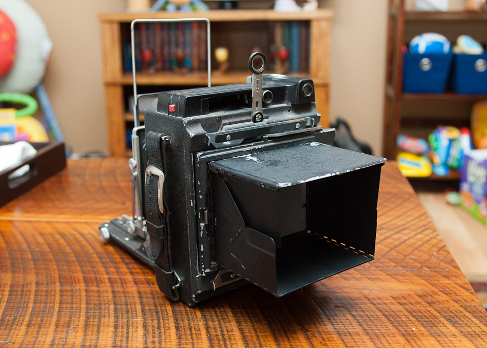

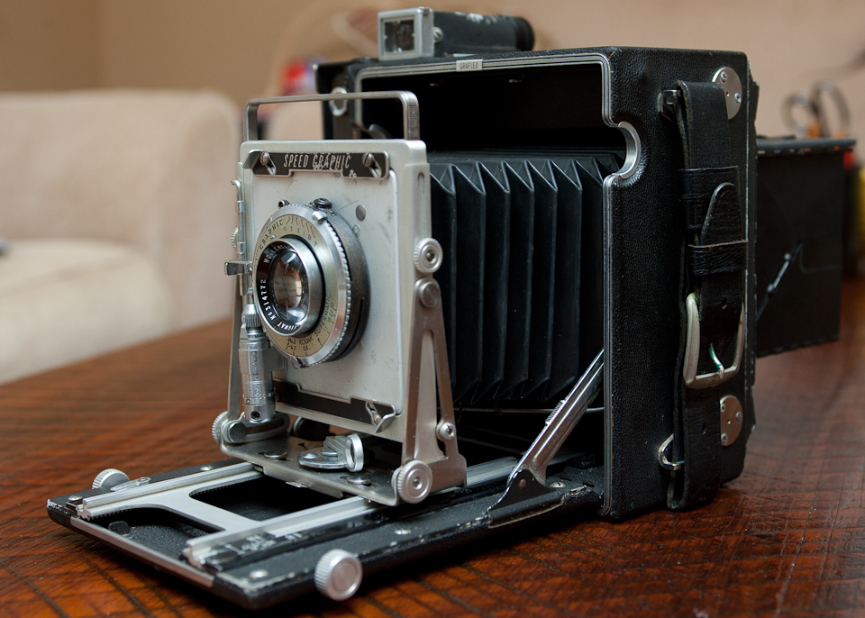

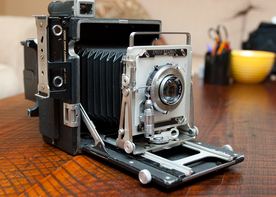

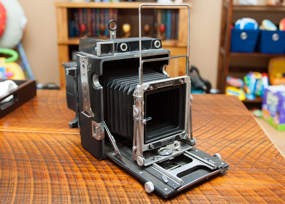

If the camera is 4x5 (as opposed to 3.25x4.25), it's a great find. Measure the size of the ground glass back.
Based on the vintage of the front standard and the newer shutter and what I can see of the metal shade on back, it's probably got the graflok back (which has spring loaded levers built into the back), which is also ideal. If the cloth shutter works, you can shoot about any lens on this, including a magnifying glass in a tp tube, indoors or out.

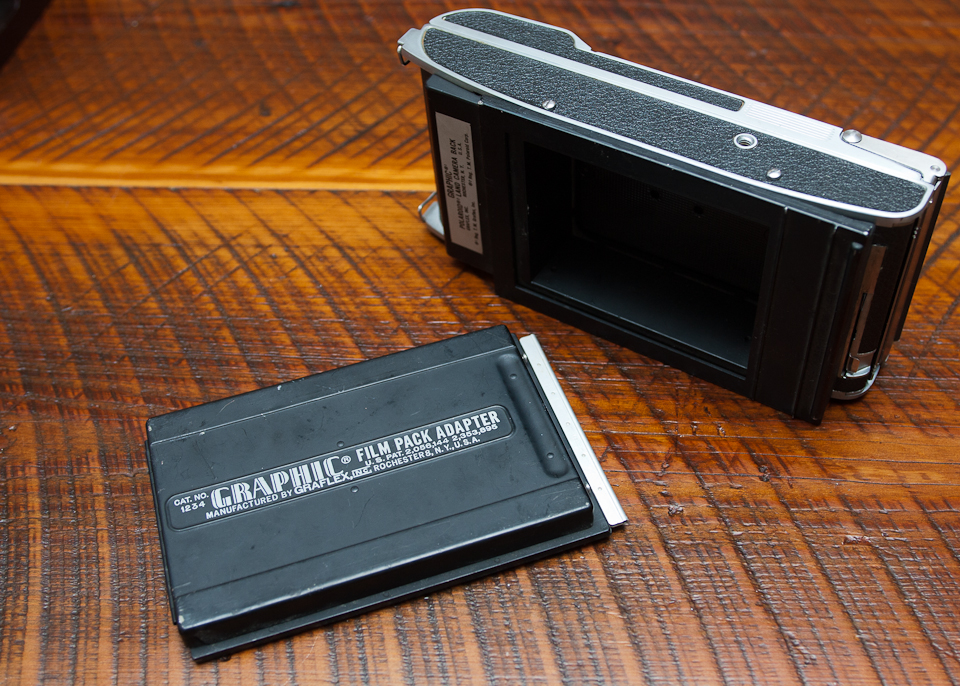

Cheapest way to play with it would be paper negatives. For low volume color, a fuji instant film back. For medium volume B&W: several holders in antistatic bags, a darkroom, box of quality film, negative pages, chemicals, enlarger or scanner, etc...
