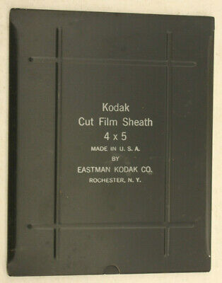

What's missing is a film sheath. It's a little metal holder that, with film in it, clips in where the glass plate would. I have made them before using thin aluminum that I then sprayed black. A Kodak 4x5 one look like this:
That one is for sale on eBay (according to Google). Not sure how easy it will be to get 9x12 ones - although easier in Europe than in North America.

My bet is they can't be printed with a 3d printer. The metal folds over to retain the film at the film plane - there's no room for anything thicker than pop-can aluminum.

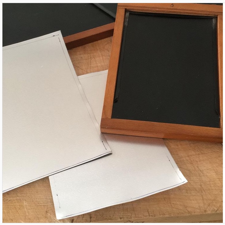

It takes 5 minutes and a pair of scissors to make one out of aluminum.
I have a set of film sheaths for my Ideal plate camera, and an Ender 3 -- I'm pretty sure the sheaths are too thin to 3D print. Even two or three layers with thin enough layer height (can go as small as 0.1 mm with most FDM printers) wouldn't be rigid enough to latch into the plate holder (at least in my Ideal, the springs in the plate holder are quite stiff, compressing the sheath lengthwise). They should be easy enough for someone with a bending brake to make, however, starting with galvanized, aluminum, or brass sheet stock (paint before bending, I think). You'd need an existing one to ensure you get the dimensions right.

I could easily set up to make them, but I don't think I will. While I like making individual things, I don't like doing it factory-style (I've done a few things that way that I've sold). If I were going to do it, I'd make a press to do all the folds at once and crimp ribs in the sheath (similar to what you see in the Kodak ones) to make it just a bit straighter. The type of holder that is shown up above looks like it could, with those four springs, make a non-strengthened sheath bulge in the middle - just about the last thing you want.
Every sheath I've seen (commercially made parts, probably from the 1950s at the latest and potentially as old as the 1920s-1930s cameras I've owned) had stiffening ribs. I wouldn't even think about putting a sheath without them into an original type plate holder; not only the springs from behind (which hold the plate or sheath against the plate holder's edge frame, to set correct flange to film distance) but also the latch that holds the sheath in place when the dark slide is out would tend to bulge the sheath. The ones for my Ideal(s) have quite a stiff spring on that latch.
The ones in my picture don't bulge. There are no springs under them. If there had been, I would've creased ribs into them. As it is, they fit snug under the retainer.
