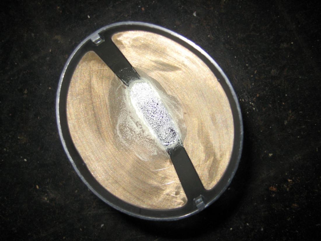

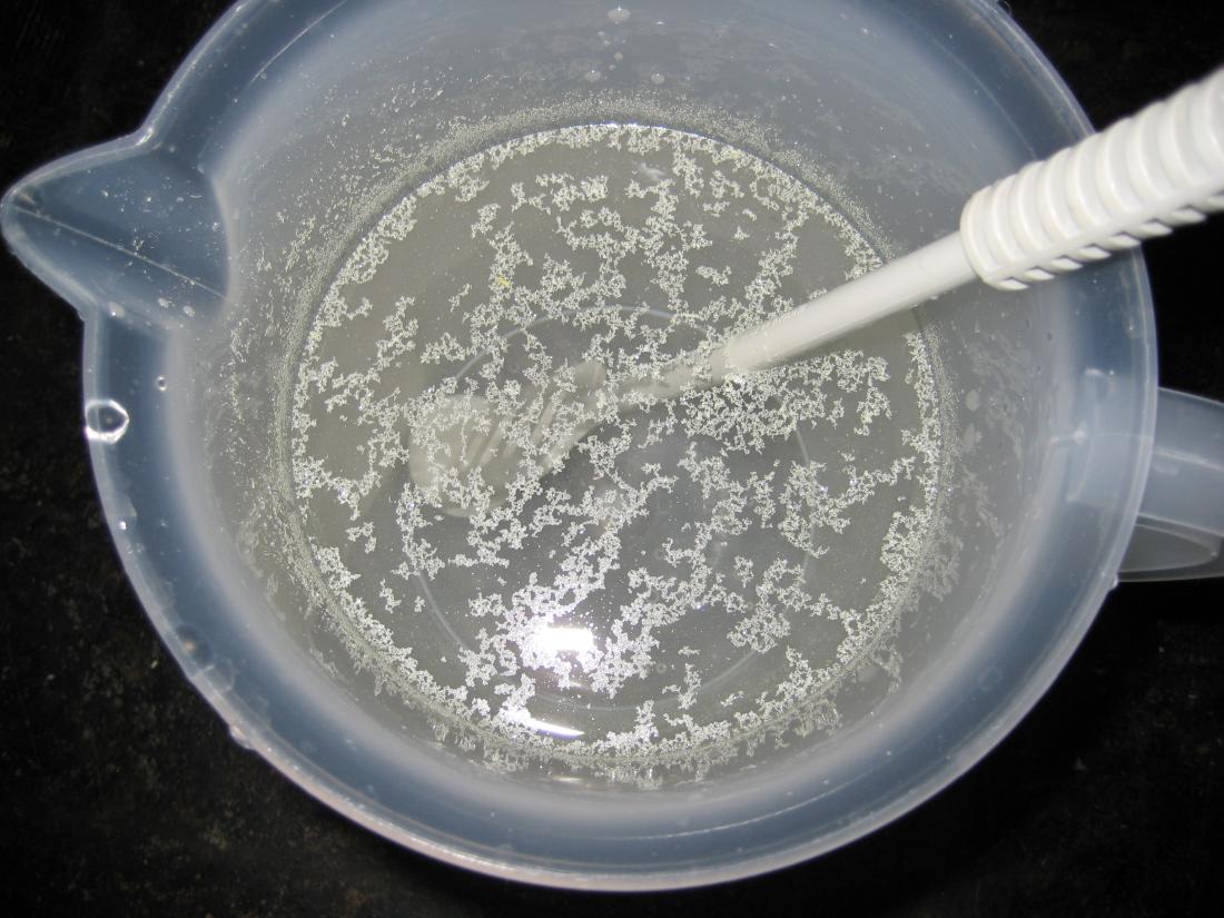

I have been buying PF ammonium thiosulfate in ten pound quantities. I use it for fixing films and paper. The most recent ammonium thiosulfate does not fully dissolve. Please see attached photo of the debris floating on the surface. The ammonium thiosulfate is mixed just as it was previously, in filtered tap water at room temperature. The debris seems to have no effect on the effectiveness of the ammonium thiosulfate as a fixer, and it rinses off of paper readily. I worry that it will become embedded in film, however. Can I filter this residue out?? If yes, what kind of filter should I use: paper (coffee filter)? metal?

You can probably filter the residue out. Use a paint filter or better. Notify the Formulary. Bud has strict quality criteria!

I take it you are ordering the thio in powder form? If so, how long are you waiting for it to dissolve? Sometimes powders take several hours to dissolve.

I forgot to add the the debris leaves a "ring around the bathtub" on mixing vessels and trays. Yes, this ammonium thiosulfate is in powder, or perhaps more correctly, crystal form. Earlier examples of the chemical went into solution almost instantly. This version doesn't go into solution even after hours.
Give PF a call, see what they have to say. They're customer service is very good.

The powdered Ammonium Thiosulfate requires +-120degrees F to disolve. Also this product may have a reaction with iron compounds within your water supply, if on a well or Chlorine if on a city water system. Your filter system should have the ability to deal with either of those.
The product also has only come from one lot # so it is the same material that you have gotten from us before.
If you want to use your filtered tap water and dissolve at room temp, just simply filter, as mentioned before thru a coffee filter or paint filter and use normally.
Thanks for bringing this to our attention and we will run a test of this today.
If we find a problem we will post on this thread.

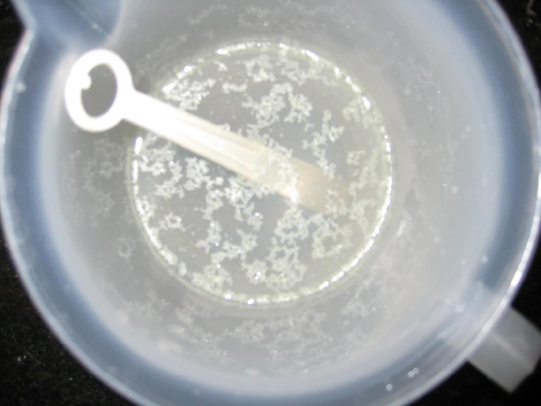

Thanxs
Bud
Darkroom day arrived and I processed some roll film and sheet film. I used a ten per cent solution of the ammonium thiosulfate I described above. The ammonium thiosulfate dissolves just fine at room temperature, but I dissolved the ammonium thiosulfate in distilled water heated to 125 degrees Fahrenheit. The resulting solution appeared as below left. I noticed no difference in the appearance from the tap water sollution I originally used. The second photo shows material I trapped in a metal coffee filter which was too coarse. Quite a bit of undissolved material passed through the filter. The last photo shows the material adhering to a mixing vessel after the solution was poured out. As before, the fixer seems to work fine. But it leaves a fine crystaline coating on reels, drums and tanks, as well as all mixing paraphernalia.
