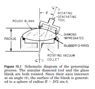

Next step is curve generation. Same bisquit cutters again. The method is well known. Below is an illustration from "Modern Optical Engineering". It works for concave as well as convex surfaces. Let the glass and tool rotate in opposite directions to minimize the risk of chipped edges. It is not a big deal if the tool hangs over the edge. The important thing is that it is large enough. So you don't need a tool of precise size but you need to KNOW the size. It is the cutting diameter that is important. I made an easy touch down on a piece of glass and measured the diameter of the mark.
Alignment is important to get the desired radius. But how precise you like to be is really a matter of how much time you like to spend on grinding. But note that it is more difficult to arrive at the right thickness if you are far from the target when you start grinding. I fitted a laser pointer to the milling head and made a scale on the wall two meters away. That helped setting the right angle. Centering is more difficult. I deliberately started milling a little bit off center (away from the center, not passing over it). The i inspected the untouched center through a microscope having a measuring scale. Then i knew how much to move the mill in X-axis. I arrived with a fairly good curve. The radius was checked with a spherometer. A spherometer is easy to make using a dial gauge and three steel balls (you can find examples on the net).
You might say that I now have my lens blanks. A little bit oversized pieces of glass with a fairly good shape.
