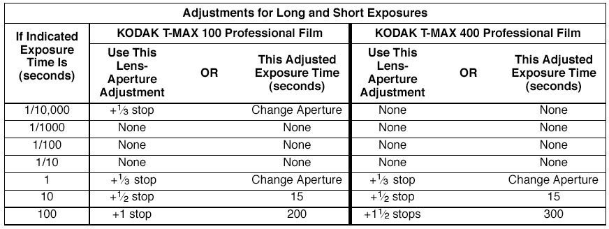

Recently returned to analog photography. The wife and I are heading up to the U.P. (Michigan) for a vacation. I plan to take my Nikons (35mm) and a recently acquired 4x5, shooting B&W only. It has been a l-o-n-g time since I've shot any night pics. and I used to have a little Kodak data reference guide, but can't find it. I'm taking TMAX 100 and TMAX 400 only. Can anyone give me some hints about exposure starting point? There is only one night shot I'm interested in getting. A local general store so to speak, at the north end of the lake, it will be lighted from within and some outside lighting around the store.
Tmax100 is great for long exposures as it suffers less adversely from reciprocity than other films, use you meter and double the exposure. The Tmax datasheet is very helpful. You can download it from the Kodak site.
Ian
Use Kodaks reciprocity adjustment figures for your film. Meter from the highlights and not the shadows. This is important as trying to meter from the shadows at night invariably fools you into thinking shadows should be lighter than they should be. It's night after all. So pick a zone 7 or 8 and work out the exposure for that. Then apply your reciprocity adjustment for that highlight value. Sometimes you find you won't need any reciprocity adjustment but I expect you will need a little.

Use the Kodak XTOL chart. Straight, or 1+1 will be excellent.; I'd use the 1+1.
