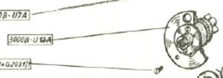

On one of my Rolleiflex from the 1940's or the Rolleicord V I had to make a light seal for the take up as the mount screws were not adequate.
Rolleicord III take up:
You have to lift the leather/leatherette covering to see the screws on the side plate and the take up shown.
