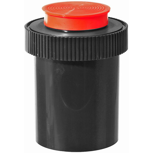

I use the tank and reels below - for both 35mm and 120. I believe the reels are the same ones OP uses. Regardless of developer, I invert every minute, for a total duration of max 10 seconds, and tend to do 1 inversion (up-down) for 35mm and 2 (up-down up-down) for 120.
I invert EXTREMELY slowly and have never seen the effect shown in OP's message.
I would suggest the opposite is true: fast, energetic inversions (think making a Martini) gives subpar negatives IME. Perhaps turbulent flow results in areas on the negative (eg those closer to the sprocket holes) being affected by differential development.
I actually bought THAT tank to get the reels. It was on sale on amazon for $15.99. The tank was leaky and terrible so I threw it away and just use the reels which work great for easy loading.
My tank is:
It works fine. It leaks, maybe, sometimes, but if it does it'll be only a tiny bit which doesn't matter to me for this. I just leave it in the sink, so I do inversions to agitate.

The tanks shown appear to have push on poly caps over the filler hole.
Years ago I read that when inversion agitatation is used, the chemicals can occasionally remain trapped in the internal filler cone after agitation.
So you have a situation were you have two fluid levels above the spiral. Possibly leaving the top of the spiral barely covered.
The answer was to loosen the poly cap after inversion had taken place. This lets the air into the tank and the correct fluid level is restored above the spool.
Of course it all depends on the internal construction of your particular tank. You will have took and see if this is applicable to your set up.

I actually bought THAT tank to get the reels. It was on sale on amazon for $15.99. The tank was leaky and terrible.
What was terrible about it? I don't find mine that bad, it's essentially functionally equivalent to my larger Paterson, which I use when I want to develop two 120 rolls at the same time. They both do what they're supposed to do I'd say.
Specifically how leaky it was. And there was no way to invert it without making a mess. And the funnel part didn't have a way for chemistry that made it to the lid to flow back into the tank itself, yet it seemed designed for the chemistry to make it out the top... my current tank has two channels, one in the middle one on the outside, so anything that makes it as far as the seal/lid will go back inside via that outside channel. Paterson's are the same.
Maybe yours is different than what I got. I just went to the Amazon ad that I bought from, and it's $29 now and the picture and the box design are different than the one I got, so... I'm guessing that is the case.
https://www.amazon.com/gp/product/B07FKK32XH/ref=ppx_yo_dt_b_asin_title_o01_s00?ie=UTF8&psc=1
On mine, literally nothing sealed. It was just a bad design, and functionally NOT equivalent to Paterson or even my Omega tank, so I'm guessing that's the case. It was shot in the dark, and there are a lot of dodgy Chinese resellers on the Amazon who sell whatever they can buy in bulk.
Holy crap! That's a Chinese copy of an AP tank. Too bad you didn't get the AP tank and reels made in Europe.
It may very well be. But it also may be the lower cost version that is/was also made by AP. The reels that (used to) come with that tank are/were also AP reels, but don't have the wide flanges.

Lists brand on Amazon as Jian Cheng.
Well, I'll say this much. The tank I got I didn't care for, but I loaded a roll of 120 on it tonight and those reels are the shiz! Just for a beginner, it's so easy to feel the square edge of the ramp compared to the round edge, and get it arranged in the right direction.
Not complaining about my tank, it works great. I really think, other than being light tight and not leaky, tanks is tanks. In fact, this thread makes me think my off-brand chinese tank would work, just treat it like it's non invertable and do the figure-8 agitation.

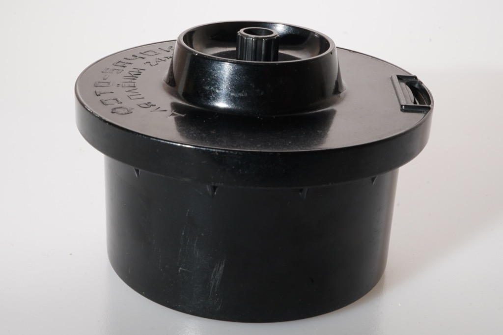

Since using the twizzle stick in my Paterson tank surge marks are a thing of the past (touch wood) and here is my reasoning. Before temporarily defecting to digital photography for many, many years I'd used deep tanks for processing 35mm, 120, and large format film and never encountered any surge marks. But returning to film I started using a Paterson tank and although I'd used them before decided to start again from scratch and iron out any older bad habits. So I started inverting the tank according to instructions and every so often I'd get surge marks, nothing where I could pin down a reason but it was frustrating. So I thought back and came to the conclusion that if the deep tank worked so well and film wasn't subjected to rushing developer or air during inversion then just twiddling the Paterson stick back and forth mimics the swishing around in a deep tank.
Of course there was a time when developing film wasn't complicated, before people had easy access to different types of dev tanks and success came because 'mine is better than yours', or magic schemes to cope with a wide range of random exposures like stand development (Sunny 16, it's your fault) . But needing a new dev tank or bromide drag aside, you got to know the equipment you had, and you used the non-existence of conflicting information to work out what you know about photography, and you did what drmoss.ca says above, you did some tests if there was a problem. Tiny details can make a difference and unfortunately threads like this are sweeping statements, sometimes with logic behind remarks, but often it's illogical, there is almost no reason why any dev tank can't give consistently perfect negatives.
The only time I had a real problem with surge marks was with Mr Qualls' monobath. They were really bad, and it didn't matter if I poured the solution into the tank with the film in there, or dropped the loaded reel into the tank already containing the monobath. In the end that's what turned me to the Rondinax tanks as the surge marks at least then were horizontal, parallel to the film edge, and present outside the image area. I can see that using the twizzle stick is basically doing the same thing.
The first developing tank I ever used was my father's 'Gnome' bakelite tank with twizzle stick. It could not be inverted as it wasn't designed to be inverted without all the solution coming out! The light tight lid would just let the solution pour out of the "twizzle-hole" and the pouring spout at the side. 1940's or 1950's era. Here's a Soviet copy:
So I guess there's nothing wrong with twizzling if that was the only agitation possible in those days!
