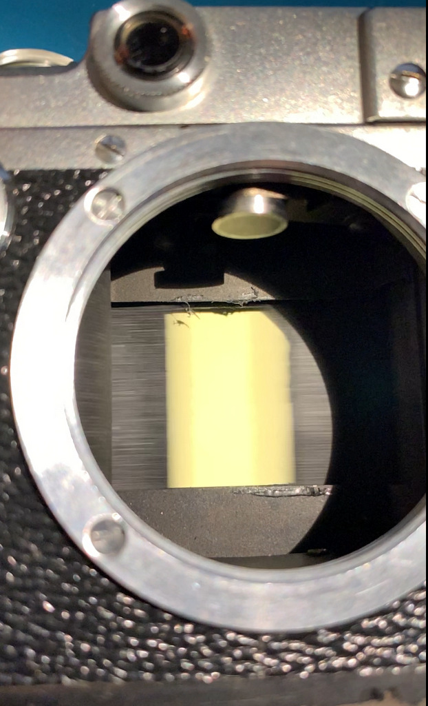

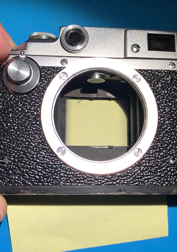

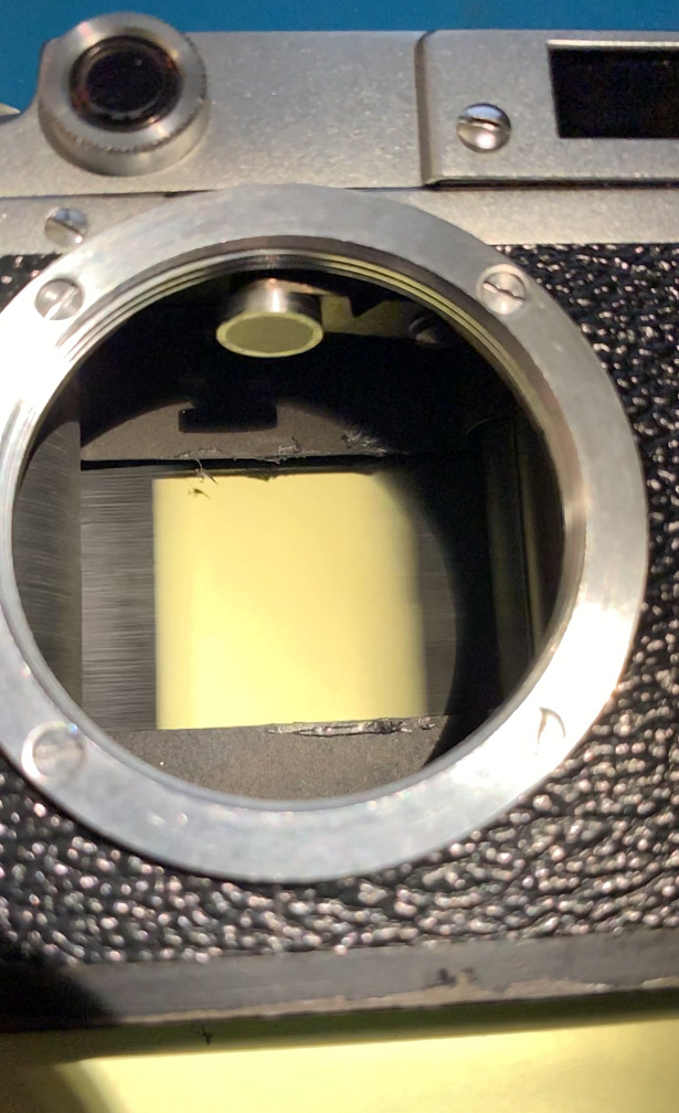

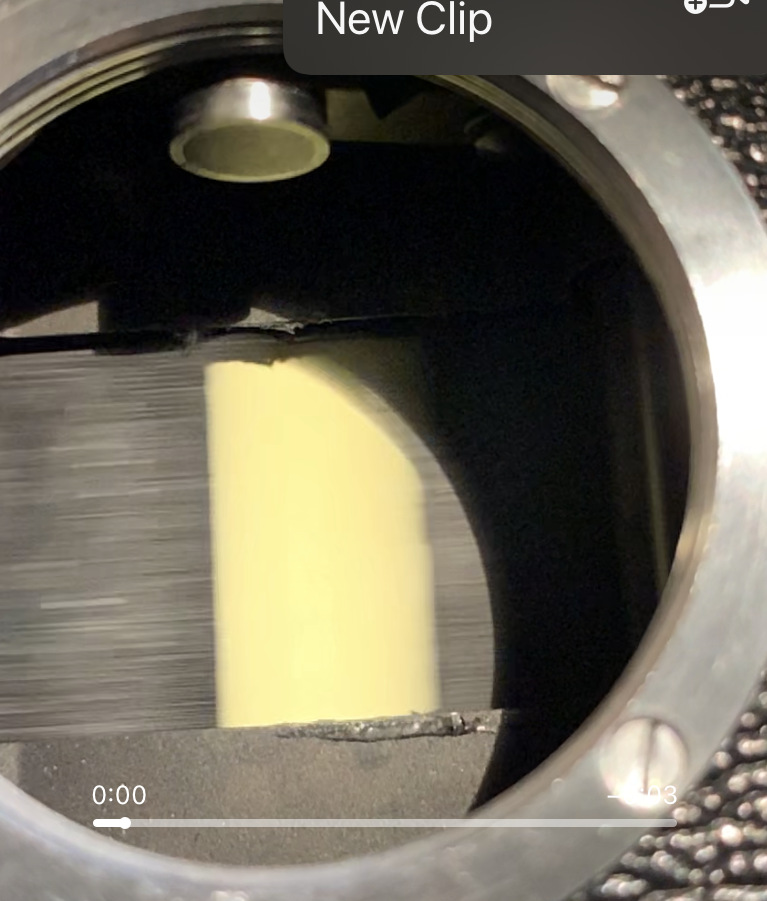

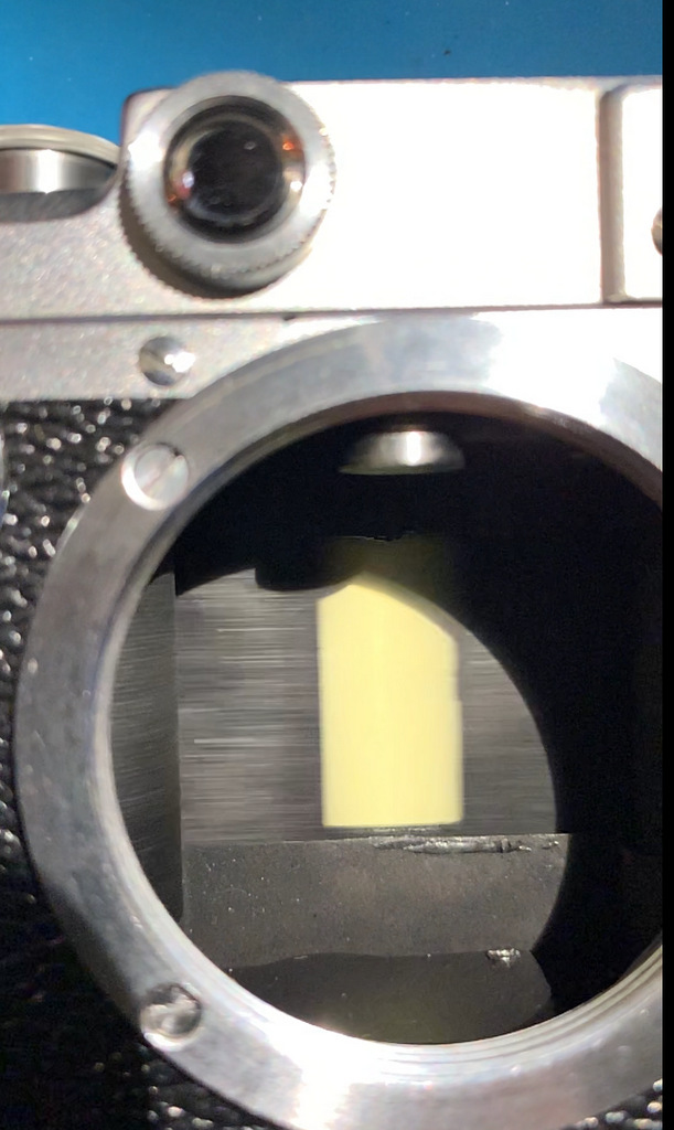

I recently discovered that I can use my cell phone to video in slow motion the curtain gap on focal plane shutters to confirm changing with speed changes. Has this been common knowledge all along? Here are some screen shots at different shutter speeds. These happen to be from a Canon IVSB but I did this to confirm the shutter at 1/1250 after working on a Contax IIIA with shutter problems. Not sure what this tells me other than the speeds do change the 1st and 2nd curtain gap, but I have no idea if these are correct. The yellow is a post it note slipped in the film plane.
I wouldn't say you're "late," but it's been known for a while.
That gap at 1000 looks too big to me.
The main thing I use it for is seeing if the gap is even across its travel. You can usually tell if the the shutter is tapering or capping by watching the video frame by frame.

Curtain gaps seem to be all over the place.
