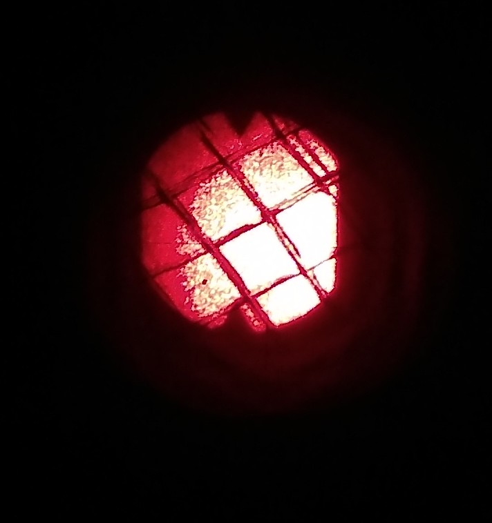

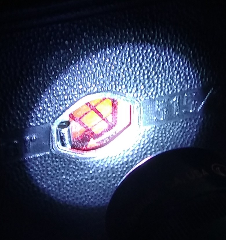

Try the following: with no film in the camera, watch carefully through the red window the corresponding hole in the pressure plate, or a piece of paper taped on the hole where the backing paper should be, while you close the camera; do you see the pressure plate being pushed back when it come against the film gate?
Ok, I did that and do see the paper flatten; I also notice what I believe is more resistance when closing the back. I can't quantify this adequately because I never performed such tests prior to making adjustments to the plate.

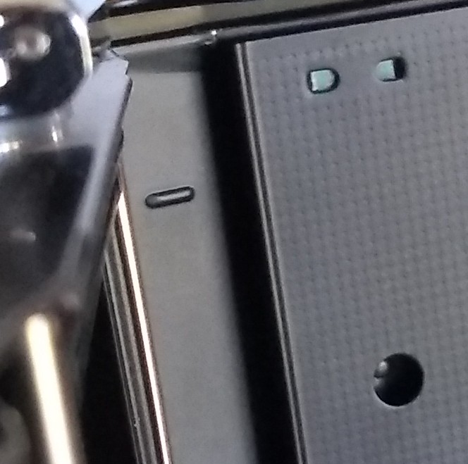

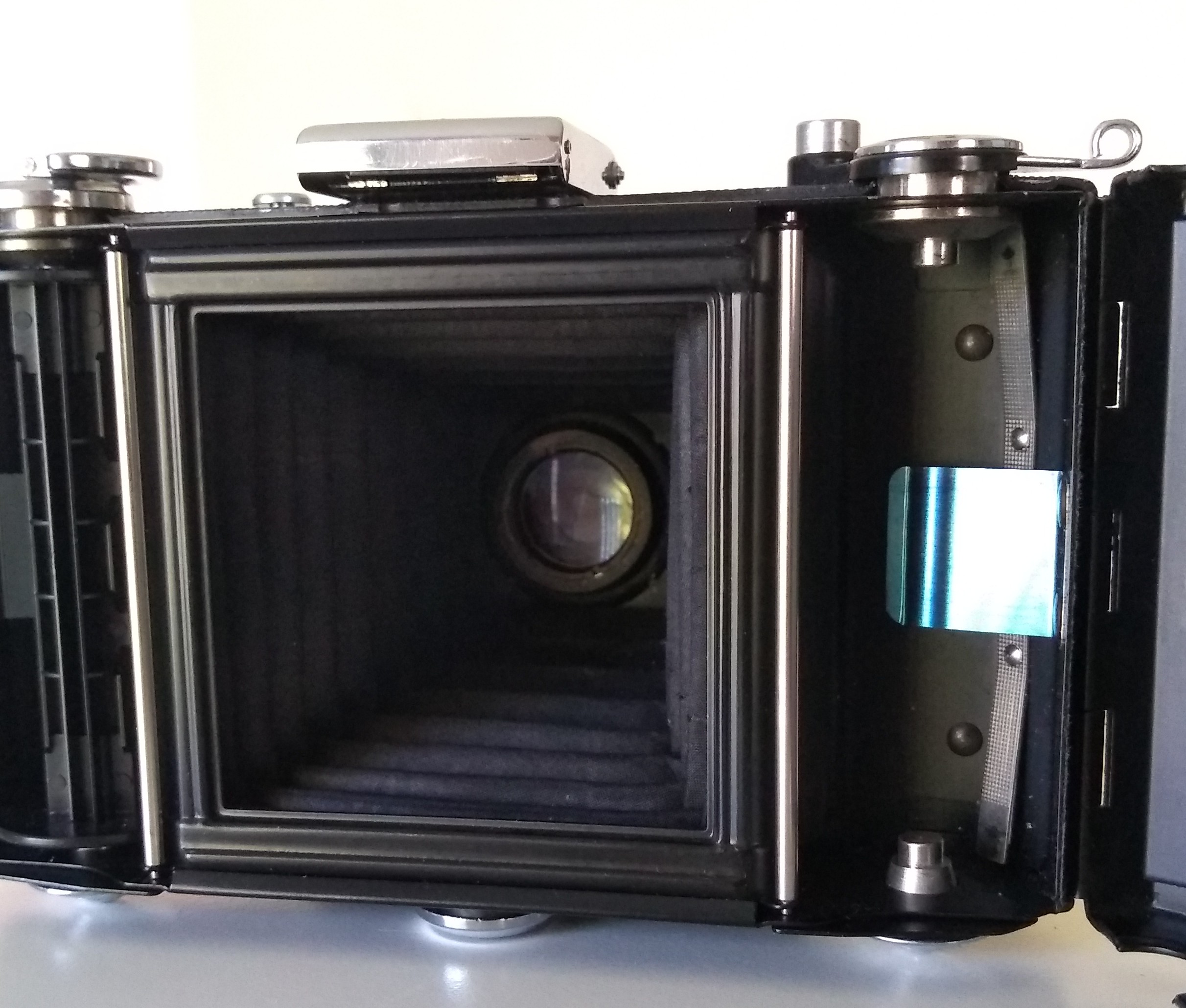

Here is the front standard. The standard folds out very rigidly; I don't think there are problems here.
Here is the plate, now extended slightly.
Here is the film gate. It seems to me that even if the plate pushes harder than necessary against the gate, the film will always be properly aligned along the flat "rails" -- that is, the film won't be pushed too far forward. You'll notice that raised surfaces above and below the rails help keep movement straight and prevent the paper-backed film from becoming skewed.

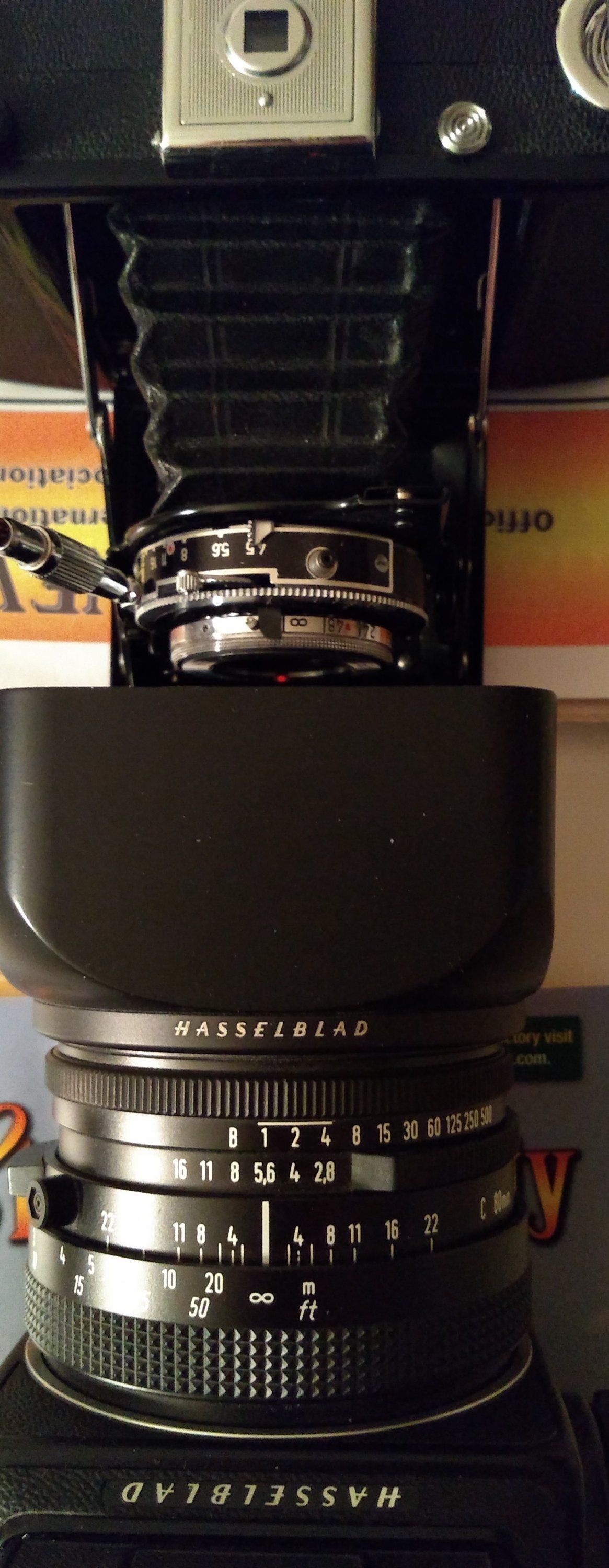

Success! (I think)
So for this experiment I placed "film" where it would go across both sets of rollers and where the pressure plate would press this "film" forward.
I actually bent the springs a bit more to increase the pressure. I also learned how to put the plate back on properly, since it popped off. At first it was a bit of a mystery how to get the springs into all four slots at once. Anyway, it's all correct now.
I placed a crosshatch pattern on the film so that I could illuminate it from behind with a strong light through the red window:
This is my test setup:
Here is a view through the Hasselblad. I checked it with the magnifier in the viewfinder as well. The crosshatch pattern was perfectly sharp. If it looks soft here, it's because I had to focus my phone's camera and it may not be perfect.
So, I think my Nettar is good now.

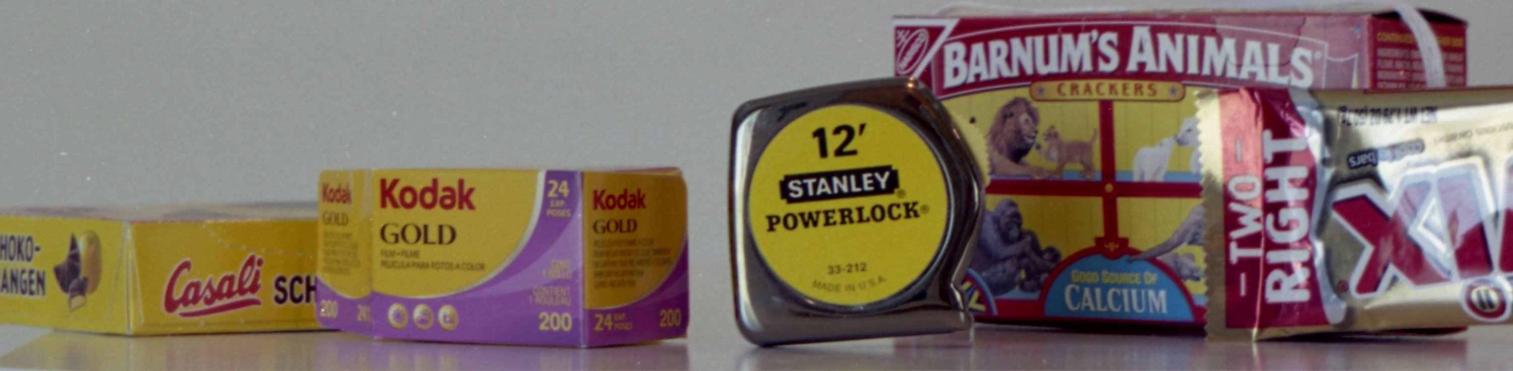

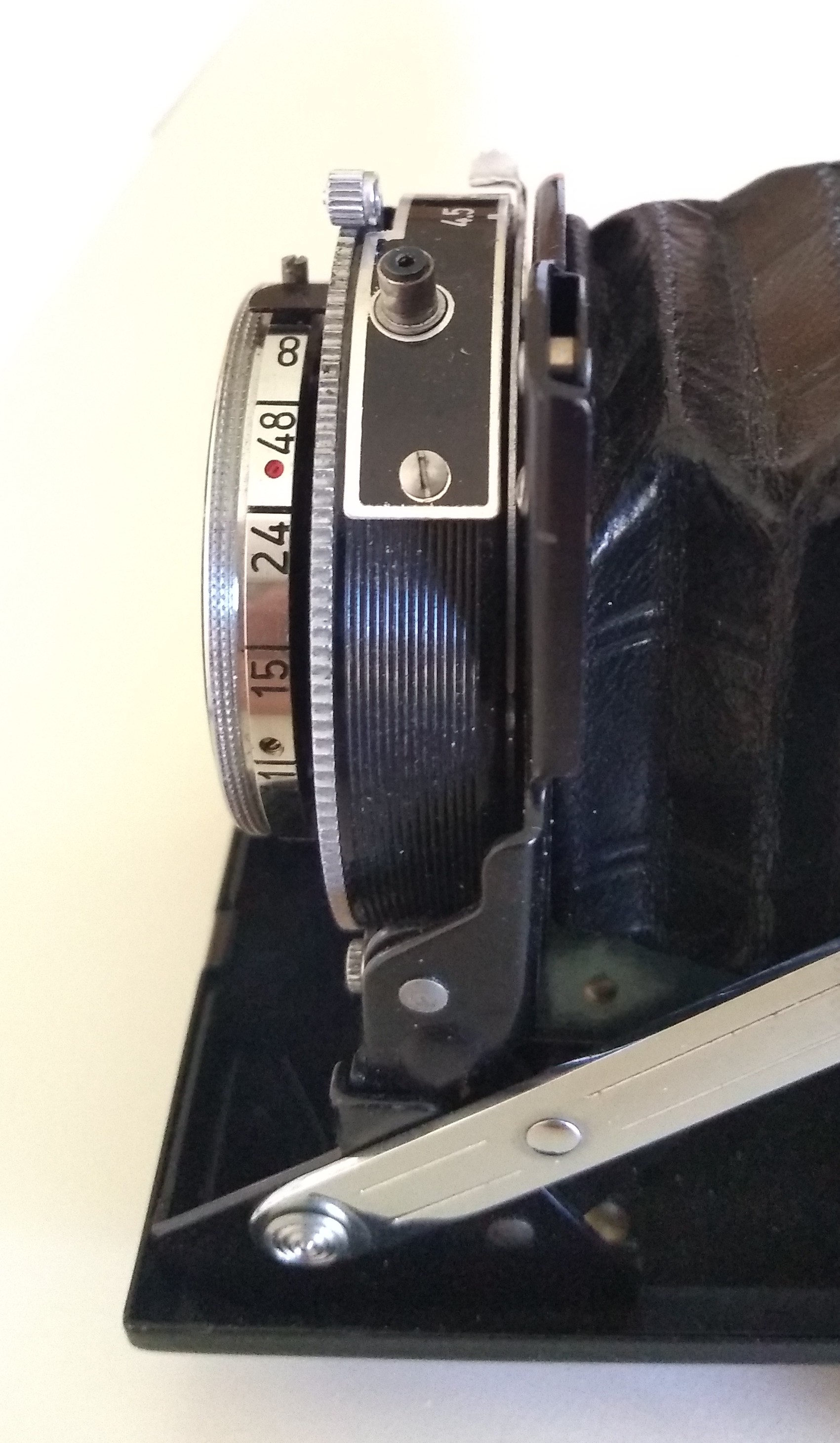

I had to test at 4 feet - which is the closest distance actually marked on the lens barrel, even though it will focus closer. Similarly, there is still a considerable angular distance on the lens barrel between 48 feet and infinity.
Once I get this situation resolved, I may put little dots on the barrel for better resolution. At the very least I should confirm what the absolute closest distance is. I believe it is 1.2m (4'11").
Anyway, I made some test photos. The only film I had available was Portra 160, so I'm going to have to wait for C41 processing before I'll know the results. That will be about a week - similar to when I was a little kid and had to wait for photos.

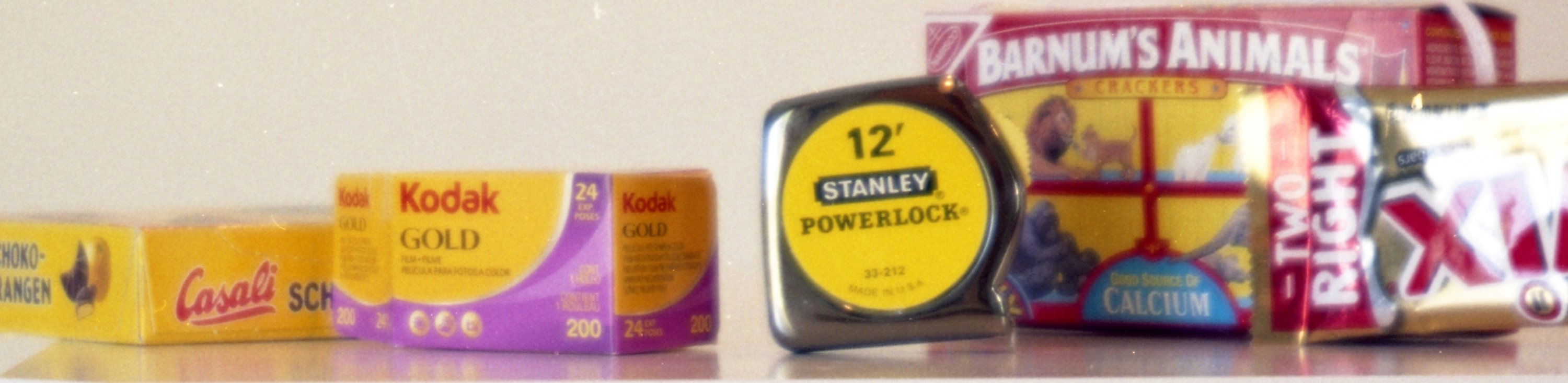

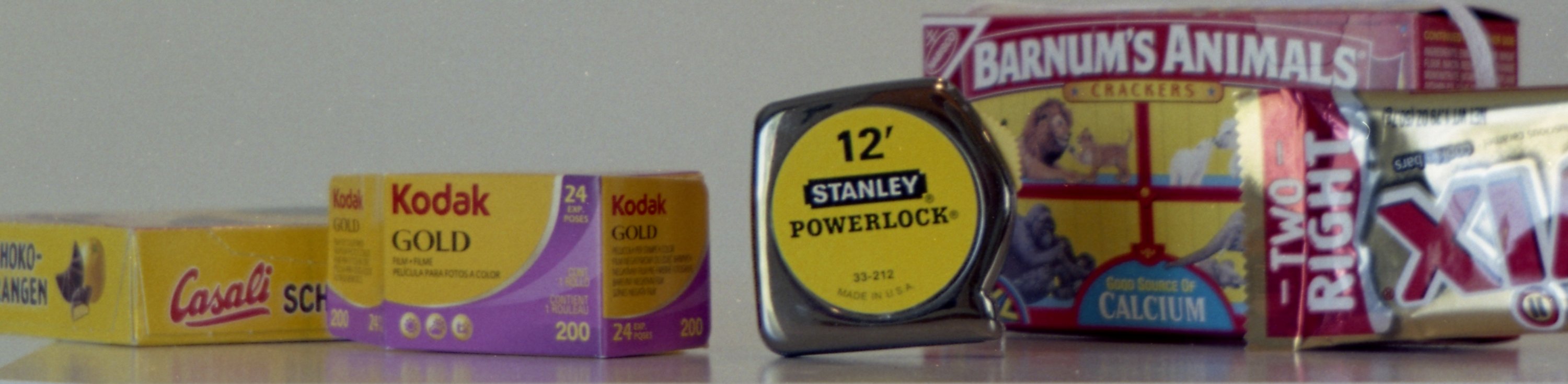

Success in both near and far focusing is what I'm seeing in my test results, a few of which appear below. This is all a result of removing the pressure plate, bending the springs to exert more pressure on the plate, and then re-installing the plate.
These photos were made at 4', the first distance marked on the lens. However, it will focus closer: the claimed closest focus is 1.2m (3'11"). The photos below are center crops from a 4800dpi scan of the negative.
4' 1/10 sec f/4.5:
4' 1/2 sec f/5.6
4' 1 sec f/8
4' 2 sec f/11
The true focal plane on the camera body is not marked, so I had to estimate this.
I made additional tests at 11', 48', and infinity - all were sharp and what one would expect from a 6x6 negative. I've determined that apertures from f/8 to f/22 produce high quality results; f/16 might be the best - at least with my camera. I see flare-like smearing artifacts at f/4.5 and f/5.6, but f/22 is very good - perhaps as good as f/16.
