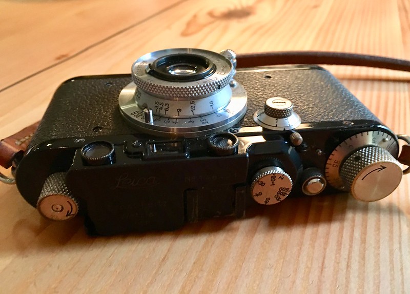

I recently purchased an almost mint Leica IIIF without the self- timer (simplification of functions) and although I have never put a film through it, I occasionally just look through the viewfinder and fire the shutter. It is the quietest Leica I have ever come across and feel I should put it to use. However, it does not have the clarity of an M2 viewfinder. Are their other Leica nutcases out there who just love the tactile feel of a Barnack camera?

Although I've always been an M user & aficionado, the early 30s lll model f, used to have had an incredible feel to it. Paired with the 3.5cm lens it was a gem. I was in Tokyo and went with the intention of buying a lllg, but after handing this, the lllG felt like it was just too big. Well worth being crazy about them!
I had a IIIG and Canon 7S which I used as a second body along with my Nikon F, although the Canon was much easier to use in the field, loading, ok meter, most lens had built in viewfinder, better viewfinder, I just liked the way the IIIG felt and balanced in my hands. On many assignments when I was not going to shoot more than a few rolls of film I would carry the IIIG rather then the Canon.

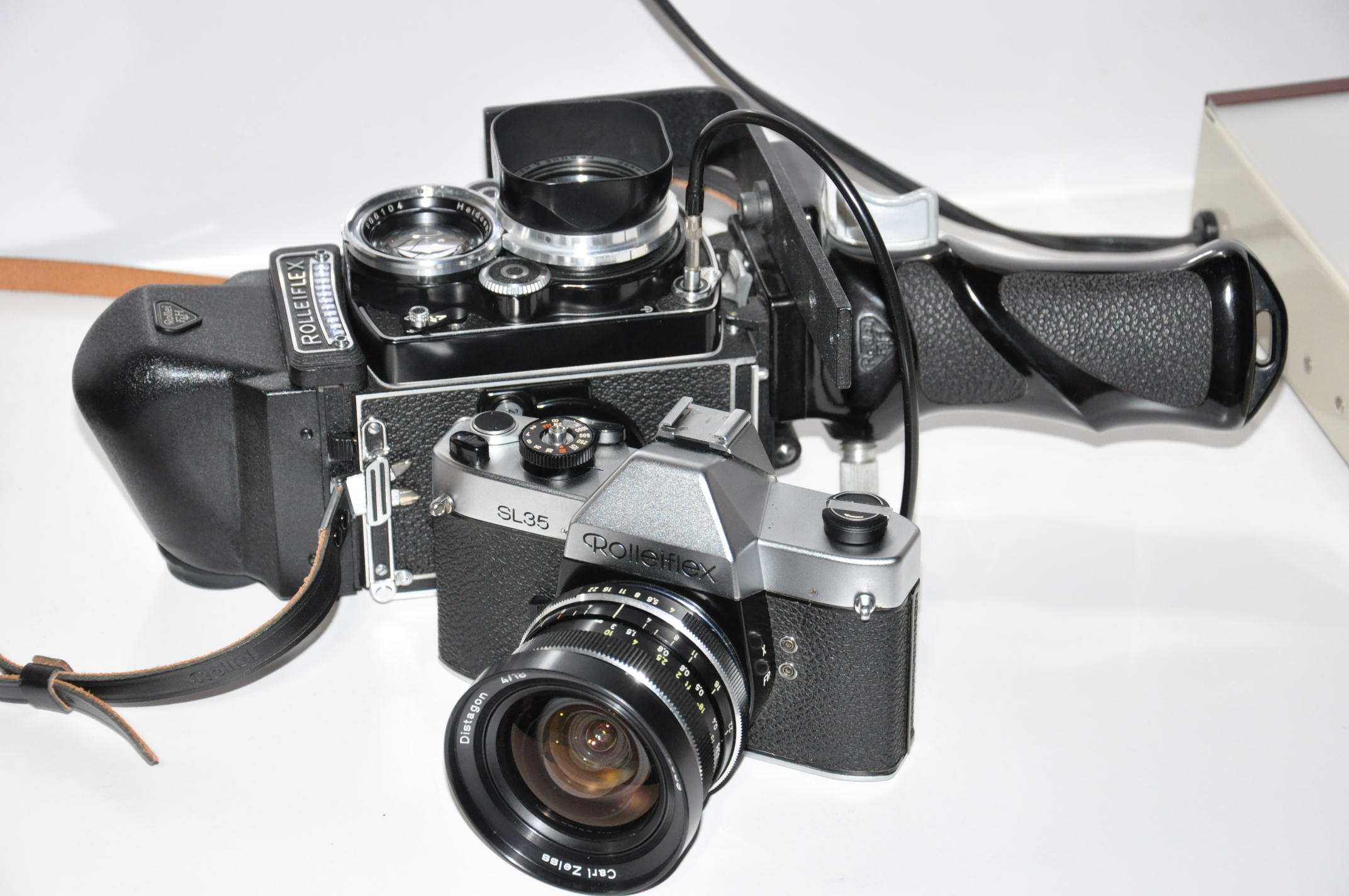

Do you have anyone who services Rolleiflex SL35s? I came up empty-handed in a comprehensive international search for anyone who would work on the SL35M or SL 35E.

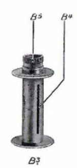

Here's a useful question: how do you get a piece of film out of the slot in the Leica cassette spool? I mean a piece of film that's not sticking out on either side.

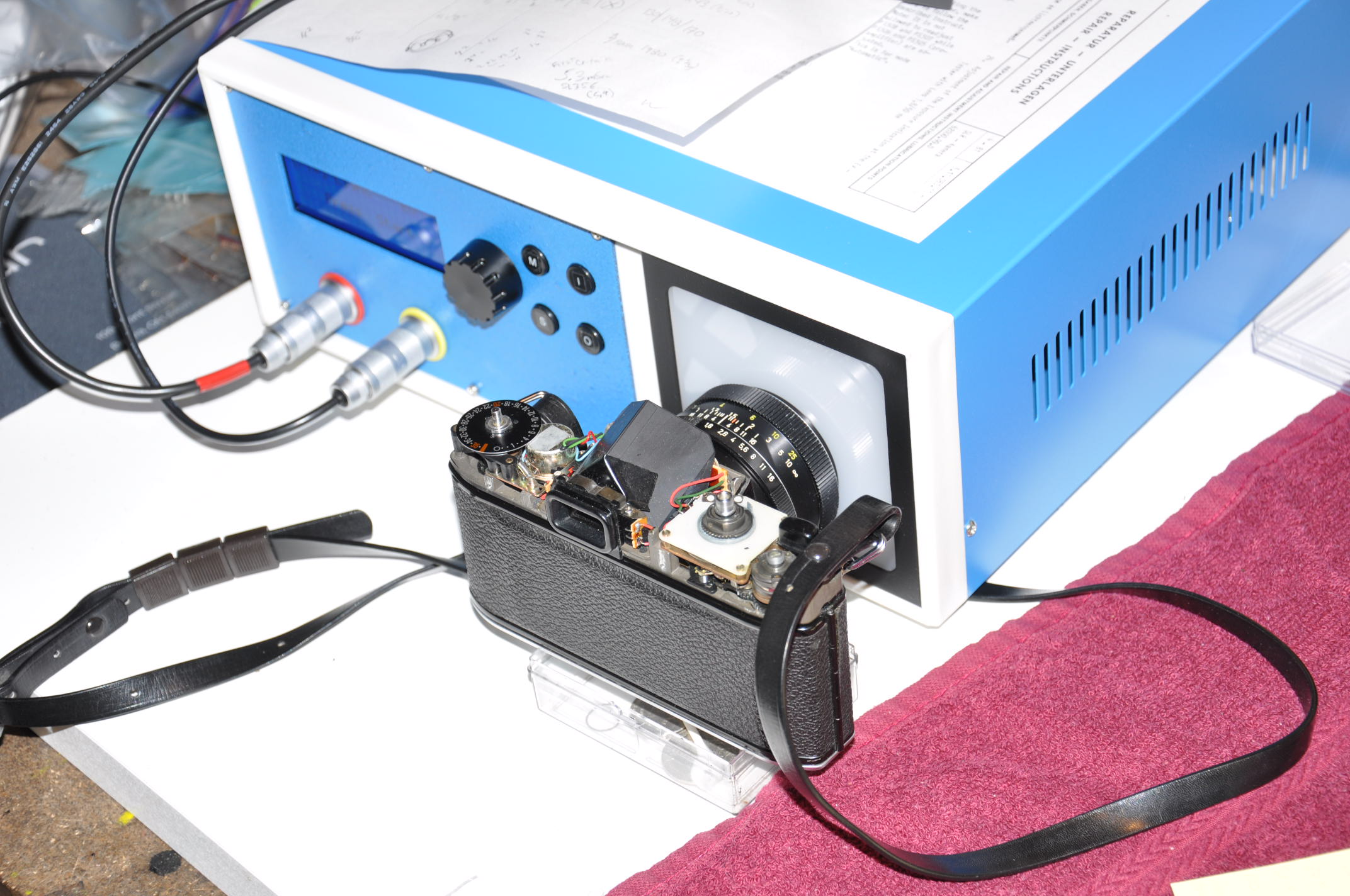

I service them myself but I did start a few threads showing some repairs:
I've never had quite that problem: I'd suggest putting through a strip of film to try to pull the piece out with it. Assuming that you know which is the emulsion side of the piece, dampen the strip slightly and insert it to catch the emulsion and give traction. Try that dry before damp. Otherwise, take the spool to pieces (not that difficult with tweezers and screwdriver).
When I have a piece left in the spool and protruding, which I usually do have as I always load direct on to the spool and not to a tab, I either 1) trim the corners of the cut-off end and pull or 2) pull through using very small pliers kept fot the purpose

The spool of a FILCA has a slot that you put trimmed film through - it's one way. You push the film in, you can't pull it out (although you can pull it through the other side). It's better than using tape.

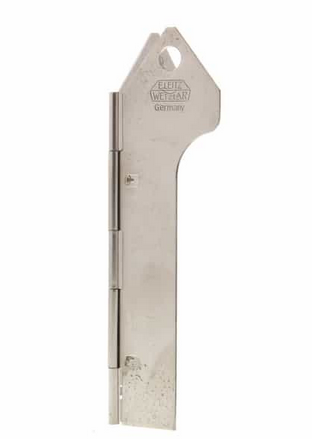

You can use the pointy end of the ABLON film trimmer to get the right shape for the piece you put in that slot.

Thanks, @Ballinderry-Michael - what happened to me is I foolishly tore the film at the slot instead of cutting across the flanges (and then trimming and pushing through) (I couldn't find my scissors). I tried using a piece of film to push it through but it wouldn't go. I'll have to examine it more closely. I didn't know there was a way to dismantle it.
To save dismantling it, maybe look at it closely to see whether a very fine pair of tweezers could get a hold somewhere. If you think it could, then maybe approach a watch repairer with the problem (I used to repair wrist and pocket watches and carried over skills from there to camera work - mainly things like leaf shutters as they contain clockwork). They might even have fine enough pliers to catch enough film to pull it through.
I use a German Filmknips to shape the end: it forms a tongue with curved sides and that protrudes right through. The point formed by an Ablon looks a bit blunt to me.

I may have been lucky that this hasn't happened to me. I trim the end of the film going into the FILCA using a pair of electrician's scissors to make short crosswise cuts between the third and fourth sprocket holes on each side of the film and then lengthwise cuts just inside the rows of holes on each side. The result is a square cornered tab that goes into the slot in the FILCA.
When I load the film onto the developing reel in the changing bag I use the same scissors to cut the film straight across as close to the spool as I can get it. Out of the bag the wide part of the film tears easily from the short part because of the weak point where the two cuts meet at right angles. It's then easy to grip the end of the film that went through the spool and pull it through. (NOTE: This does not work with polyester base film. It doesn't tear!)
I took it apart (just a few minutes ago). Worth mentioning is the two small finely knurled cylinders (1/4" long, thick as a pencil lead) that want to fall out and disappear. Luckily they're steel and stuck to the screwdriver I used (although I was disassembling this over a large bowl - it wasn't possible that they're just disappear). There was no other way I could get the film out - none was sticking out the back and I couldn't push it through. Reassembled, it works fine (a bit tricky getting those two bits of steel back in there, though. Must've been a fun job for whoever did it at the Leitz factory.)
A couple of very small bits of film fell out along with my stuck piece. It's always been a bit difficult to get the film to hold in this filca, so maybe it needed to be taken apart, anyway.
I generally cut the sides curved to a strip about as wide as my thumb and it works fine. However, after I got it back together, I cut a piece of scrap film the same rough shape as the ablon template. It went in nicely, stayed in, the tip stuck out the other side, and it wasn't that irritating to cut the film to be able to pull it through.
