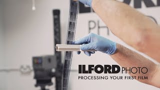

A picture is worth a thousand words. šŸ˜Ž
Words like:
Marketing
Amateur
Scratch
Scratches
Why is my film scratched?
Do I really need to have my film dry 2 minutes faster?
Drip
Dripping
Etc.
Also the following words: Labs do this to save time and energy. Money over care.
Labs use exhausted fixer, exhausted developers. Labs are in it for money. Labs develop 100 rolls with one D76 bag.
Labs will always tell you that your camera is under exposing, and you will never know since you don’t have the power to analyze your equipment because you do not develop yourself but let a Lab do it for you.
How many words is that? I could go over 1000 easy.
It is unfortunate when people suffer from dealing with poorly run labs.
Almost all the labs I've used were/are meticulous and careful. They are also normally more expensive then some of their competitors. They rely on constrol strips and other moderately expensive means of maintaining quality, and they have sufficient volumes of work for that to make economic sense.
The quality of choices available to me locally is quite good. I realize that isn't the case in many areas.
If they use a squeegee, I would trust them that it would be "a high quality, well maintained, properly used squeegee in the hand of an experienced operator".
I doubt employees in film manufacture itself are wearing linty sweaters and instruments with built up grime. Those are true clean room operations. And comparing that to casual darkroom habits, or typical home darkrooms, is ludicrous. In other words, if a picture is worth a thousand words, maybe that very picture would result in a thousand less words on this thread excusing sloppy procedure.
