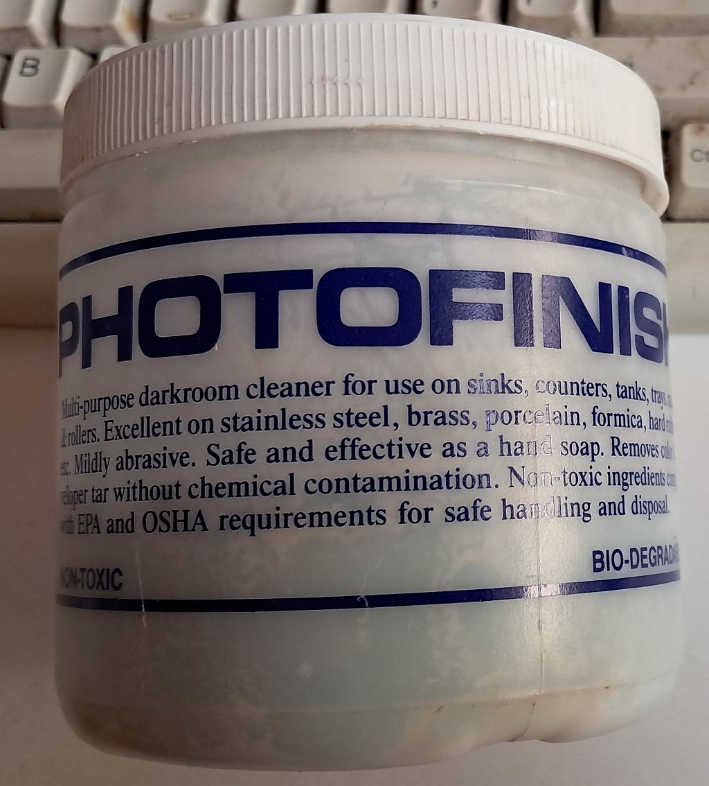

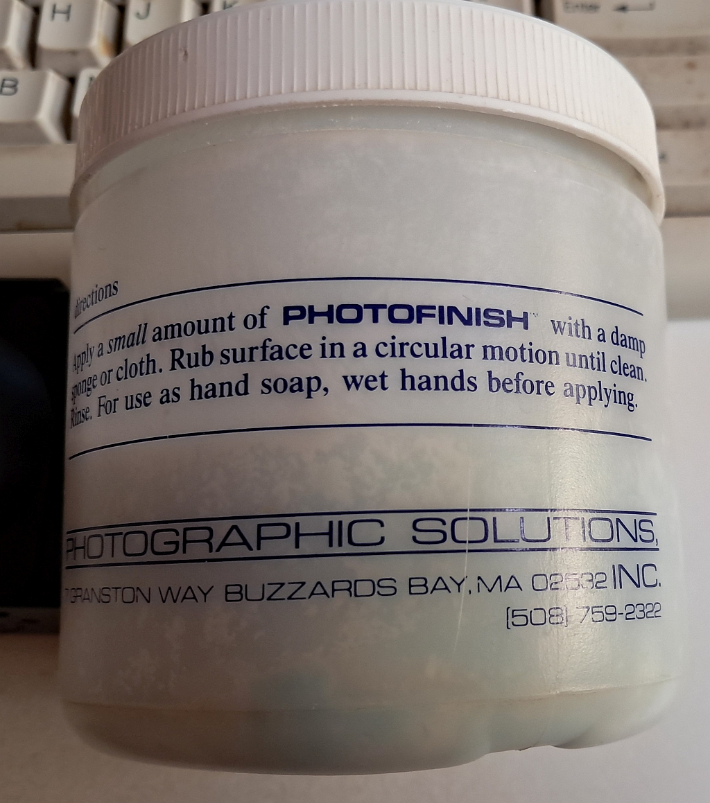

The last product that I bought and still have, is Photofinish by Photographic Solutions Inc in Buzzards Bay Massachusetts.
It is a paste and I used it to clean RA4 tar deposits from the rollers of my Durst Printo paper processor. It worked well.
What I have is marked 22 OZ, but to give a better size idea, I would suggest it is about the size of a normal 500gms plastic screw top container.
I have no idea if this is still manufactured, but this did work and was incredibly cheap when I last purchased it, which was around 8 years ago. My first purchase was probably around 25 years ago.
Edit:
I just read the list of what it can do, one of them is to "Removes colour developer tar without chemical contamination."

I've used the PhotoFinish cleaning paste that Mick mentioned. It may be quite good for cleaning RA4 tars but in my experience it was overkill for anything basic like tanks, bottles, trays, etc. It also had a tendency to leave a strange, waxy residue on everything it touched, which required you to meticulously wipe everything down with a dry towel after washing (i.e., a simple water rinse wouldn't cut it). For that reason, I switched to using an aqueous solution of washing soda (sodium carbonate) for basic darkroom cleaning.
