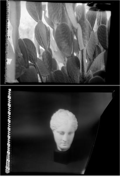

Polaroid type 55, @ ASA 32, 10-15min Perceptol . . .
Neither is a beauty of a shot.. but they serve the purporse of validating the usability of the polaroid film independent of it's chem pack.
Thanks very much for all that have furnished the info that served as an impetus to this "discovery" ...
First impressions -
VERY fragile and thin film base. Developing some system for removing the metal tab and the chem. pack in the darkroom will be a must if the film is to be used "convenitonaly". . . . There will be alot of handling of the neg, and having something that can do the cutting, premeasured, is key.
Please ignore the fibers from the paper towel, and.. the ... "nick" in the corner of the lower one... there was also some issue with the top neg folding... or something.. it didnt develop, but that may be b/c I had to bend it to get it into the tank, and then it might not have been covered by the chemistry....
As an asside - I realized that I also have two boxes of type 52, i.e. pos/neg 400 ISO.. but both of those negs came out SOLID black... so they are either gonners, or there is something wonky with the developent... I exposed those at 200 ISO, and still nothing but max density on the neg.
