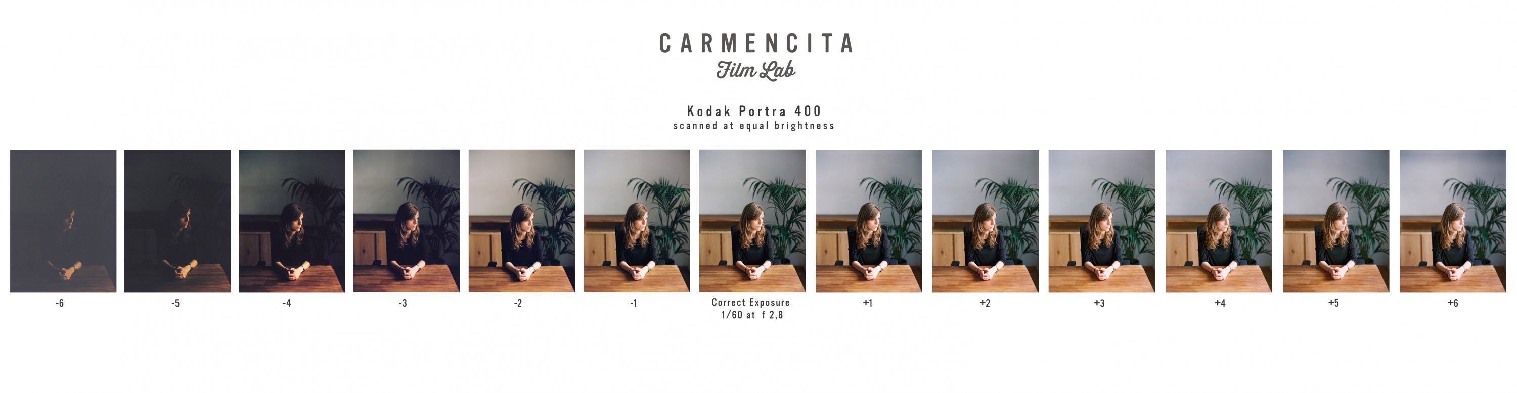

Negative film usually offers way more than 5 stops latitude, with POTA developer one may cature up to 20 stops, being 18 quite easy. Another thing is being able to print that dynamic range on paper, or showing it in a monitor. See this color negative film exposure test made under regular development, the girl's face (and hands) has detail at -6 but also at +6, probably at labeled "correct exposure" face was at some +2.5 locally so in the -6 shot the face would be at some -3.5 locally, at +6 image still has good detail so for sure Portra sports more than 12 stops range, before we no pull.
(https://carmencitafilmlab.com/how-exposure-affects-film/)

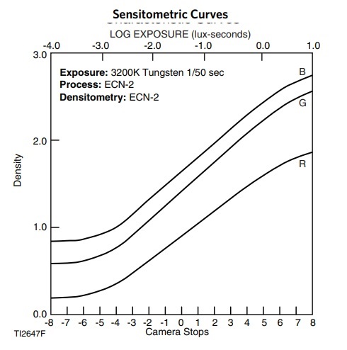

This is the Kodak Vision 500T graph, contrary to still fim, this stock film datasheet shows latitude in stops:

I depends on film processing, but we can easily get well beyond 7 stops...
