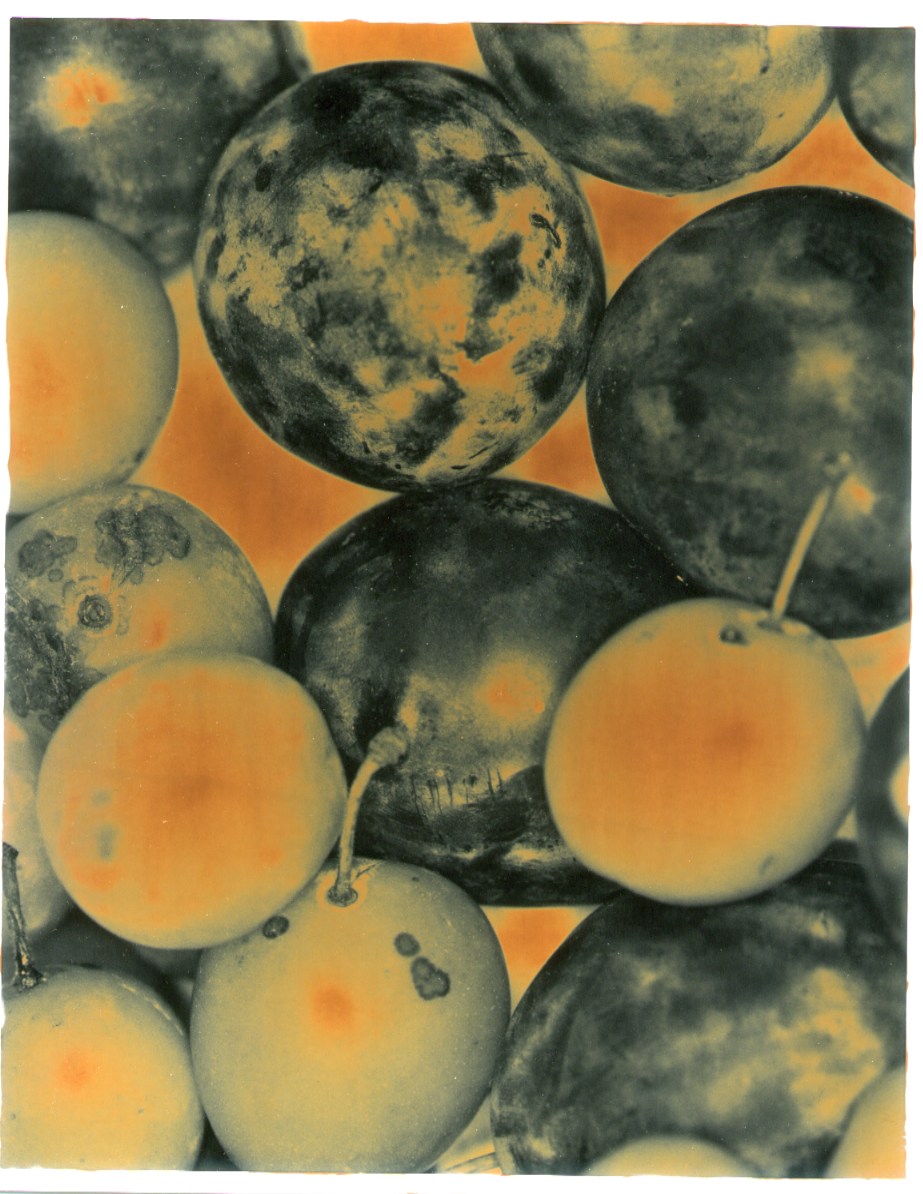

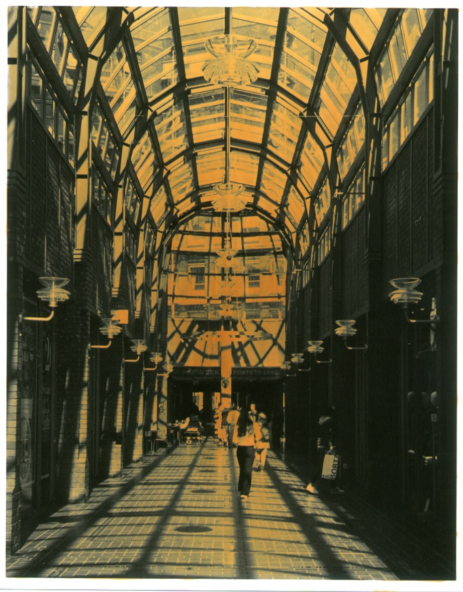

Today I received two fascinating prints from Bernd (RauschenOderKorn). They are made by the Chromoskedasic method, which I never heard before. I saw however, examples form that already. These are the most interesting photographs I got form an exchange ever. If you look at the images: They are made from b/w material! Unbelievable.
Recht vielen Dank!
