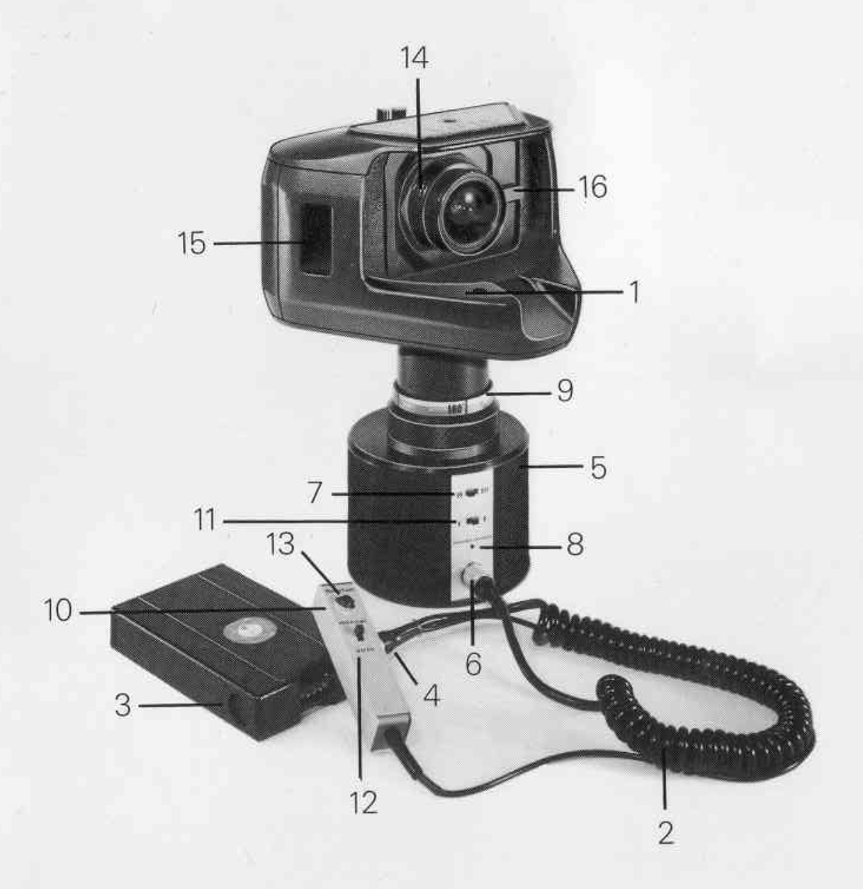

I recently acquired acquired an Alpa Roto and it seems mostly to work fine. There are a couple things about the camera I can't work out though - for example I can't work out how to preselect an angle of rotation. The angle preselctor (labeled '9' in the image) on my camera doesn't move at all, and I'm unsure whether it'd be wise to try to force it.
Does anyone have experience using this camera? Thanks!

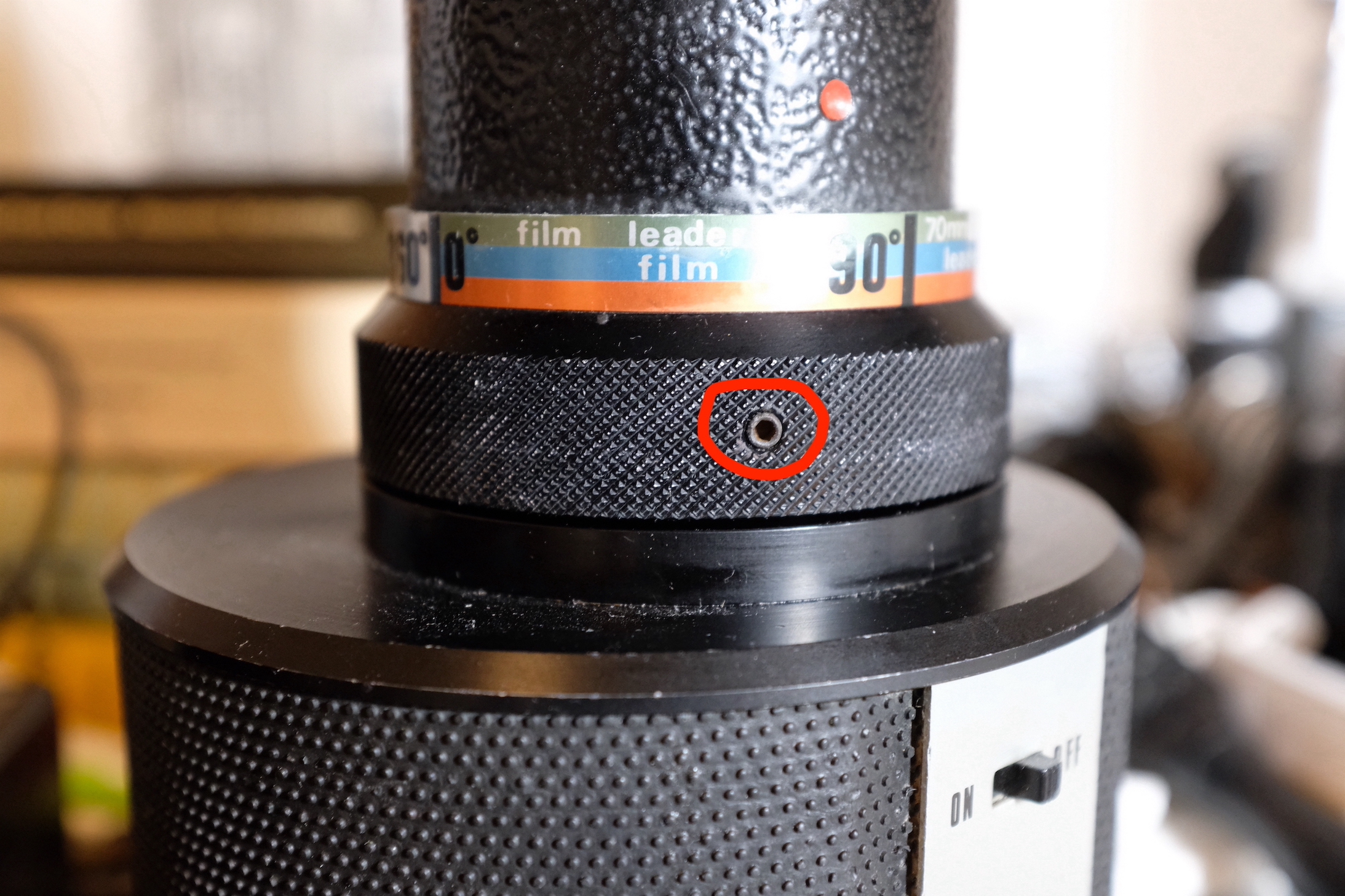

Very interesting. Do you mean these grub screws? I have fully removed them in the past and there doesn't seem to be anything behind them.
Thanks again
Thanks again
Yes , there should be a plastic rolling ball held in place by a tiny spring. So if you want to che k on this you will have to separate the head from the motor as per earlier instructions. The ring is part of the motor. The principle of functioning is that there is a invisble to the eye magnet, worked in the ring and that serves as the reference for angle. So it cuts off as it passes this magnet.
