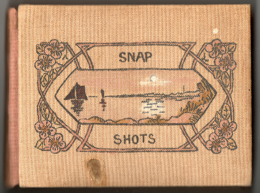

I have one or two little albums which are not quite full. I like producing miniature prints which have so much condensed detail and they look nice in small albums.

View attachment 177022 I have one or two little albums which are not quite full. I like producing miniature prints which have so much condensed detail and they look nice in small albums.
Sweet! What size are we talking here?
