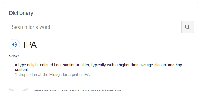

Which beer are you adding? Interested reader want to know!

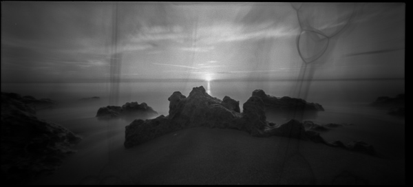

I always used LFN. Been using it for 25 years since HIE always got air bells without it. The last good bottle I had was the little white one that said "frying time" instead of drying time. The bottle cracked a while back and I got one of the new clear bottles with a red label. I don't know what they did to the stuff, but it is terrible now. The first tank I did with it and Pyrocat mixed in Glycol was unreal. Foamed beyond belief. I guess it was the combination of the LFN and the Glycol. Definitely not the same stuff it used to be. I stopped using it and started getting the bubbles with my JOBO reels. Drives me nuts! I'm glad IPA works. I'll start using that.
This is what the film looked like with the LFN-
