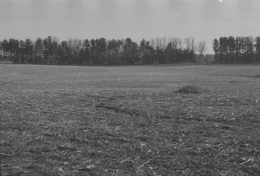

You said earlier you “can see the sprocket holes right on the film.” If by that you mean sharp images of the sprocket holes somewhere within a frame on the film, you can safely rule out agitation as the cause no matter what tank and agitation technique you’re using. Developer and fixer cannot flow or not flow so neatly.
Vague streaks across the width of the film at about sprocket-hole spacing would be a different matter.
This, although not vague.

Looks like surge marks to me.

Try gentler agitation. I do 2-3 inversions in 5' in Paterson and Jobo tanks. Having the tank full also helps, leaving a lot of empty volume will obviously make agitation more vigorous. Agitation brings fresh developer on the film and removes development byproducts from where they form, which affect development. Even gentle inversion will get the job done.
They could be surge marks, although I'd be surprised even with continuous and heavy agitation for them to appear like this. I think a light leak somewhere still cannot be excluded.

I believe these are surge marks. I have rolls where they don't appear at all, and some where they're as you see. The roll that has them the absolute worst was one where I was low on developer. On my next roll I'm going to try the Paterson instructions for agitation (i.e. one inversion every 30s), and see how it turns out.

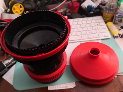

Nice build bnxvs! Did you calculate how much more liquid you need when running horizontally?
Horizontal agitation does not imply the use of different volumes of working solutions. You have only one indicator for calculating - cylinder volume / 2. It is easy to determine this simply by filling the tank with water (of course by first making a lid). So, whether you will develop 1 or 2 135 mm films or 120th film, there is no difference. )))
Ah yes, of course. So it is basically the same liquid amount as when using the tank "fully loaded".
Have you calibrated your developing time with this? Or have you noticed contrast increase?
I usually calibrate any film, developer, etc. in case of changing processing conditions. In my signature you can find a link to an online densitometry plotter.
I attach files for a 3D printer (if someone needs it).
Nice that you shared the design.
In general how did the development change with constant rotating agigator? What developer do you use with that?
