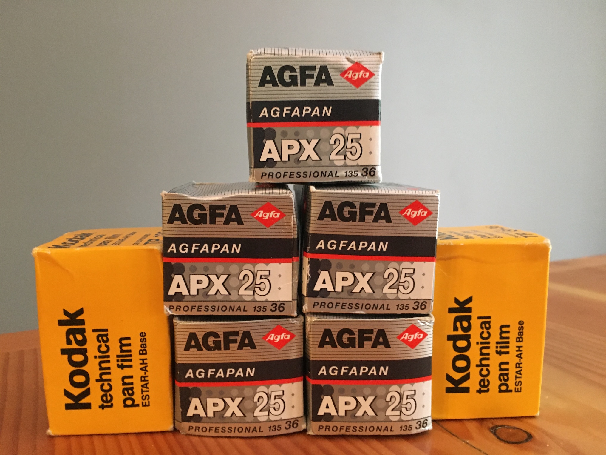

Thanks for clarifying the differences between the heritage of the old Agfapan APX 25 and the current film that is the subject of this thread - Agfaphoto APX 100.
Pretty much a sideline illustration to xkaes comment...... not unlike your bringing up digital in a question in the analog sub forum......
And a helpful one too!
And let's not forget AGFAPAN 400, too. They were all great (ISO 25, 100, & 400). Yesterday I defrosted some Agfapan 400 to take some 4x5" portraits of relatives who happen to be in town. The three Agfa B&W films changed their labels over the years (ex., Agfapan 25 vs Agfa APX 25) but I never noticed any difference.
