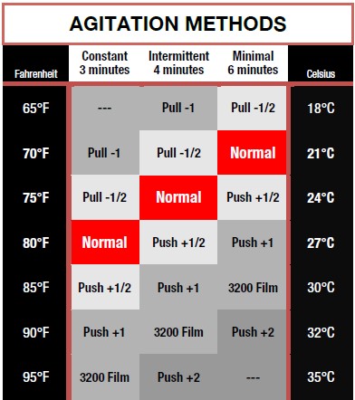

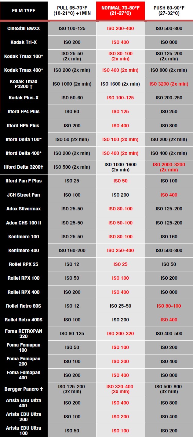

On the chart above, does x2 mean increasing the developing time?
