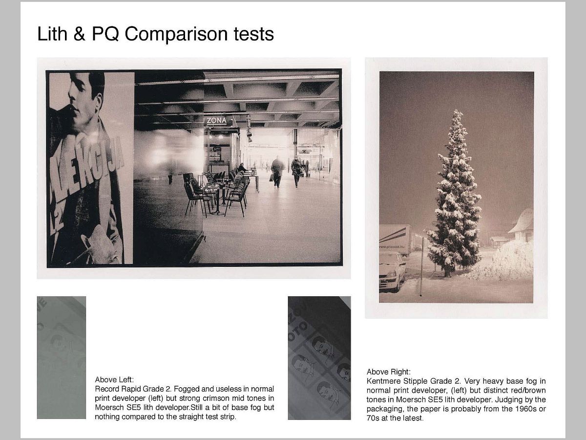

I recently was involved in heading a large group project using a big supply of outdated paper.
https://obsolete-discontinued.com
The Brovira in general was in quite good shape although was probly around 40 years old. However, the Record Rapid was really badly base fogged. Probably younger than the Brovira judging by the packaging. All the papers were stored in the same darkroom. This is not to say that if stored in better conditions Record Rapid wouldn't print better.
But........ it was great for lith printing. I've attached a screengrab from a pdf I put together when I was testing the papers at the beginning of the project. RR on the left hand side. Though as tedr1 points out above, the last batches had Cadmium removed so don't know if this paper was from earlier batches. (Expect it probably was). Though I still have the packaging if anyone is good at dating Agfa batch numbers.
This was the final result of the participant who used the RR. Am amazed how he lith developed nine sheets together!
