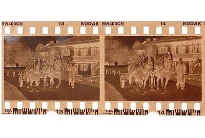

Can you post a photo of the neg strips please.
Something like this.

Heres an image. Please ignore the dirt. I tested some new chemical bottles which unfortunately had residue in them which I missed during cleaning. That residue is now on the negatives as spots.

Thanks for posting the photo of the negs. It is always a great help to view the negs in full.
