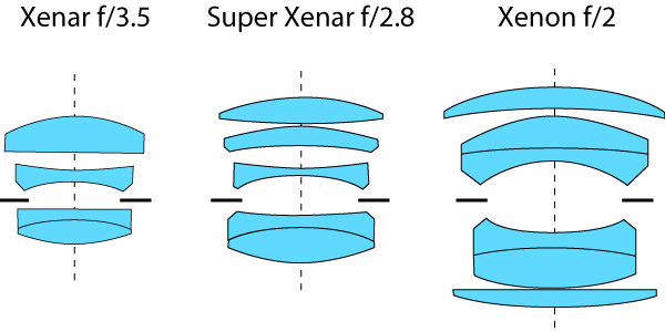

I just got a Karat12 with the Karat-Xenar f/2.8 lens - 4 or 5 element?
If it's a five element Xenar, with the shutter closed you should see six reflections in the front component. That should be easy to see because the the front component has three uncemented elements in the five element Xenar, while the normal Xenar has two (four reflections).

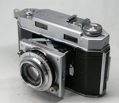

I have one with the Rodenstock f2.0 lens. It needs a whole bunch of stuff - the focusing is incredibly stiff, the shutter speeds are off, and the film advance has issues. I like the ergonomics of it and the overall quirkiness, but it may end up sitting on the shelf as a display piece because the quote I got for overhauling it was in the $600 range. If anyone here knows someone who would tackle it for less money, I'd be open to any suggestions.
It shouldn't be that difficult unless the bellows is broken or the link to the RF is gone.
Focusing helicoid can be cleaned, I moved the lens to the closest focus (1m), and then clean the helicoid with Qtips moistened in electrical contact cleaner/acetone. A lot of black/green goo came off quickly, exercises the focusing and repeated a few times
It is not buttery smooth, but is easy to work with now.
Thanks, you are right.

I finally relented and got a couple of Karat36 from fleabay
The Karat12 has a great lens but I cant find the cartridges for a decent price.
I bought 2 Karat36 version 3, with a Solinar 2.8, a Rodenstock Heligon 50/2, and a Ansco Karomat (rebadged) with a Xenar 50/2.8.
The Karomat and the Solinar cameras were not in the best shape, but using one as donor it allowed me to have a fully functional camera.
The hardest part after regreasing the helicoid was to put it back in the right place
