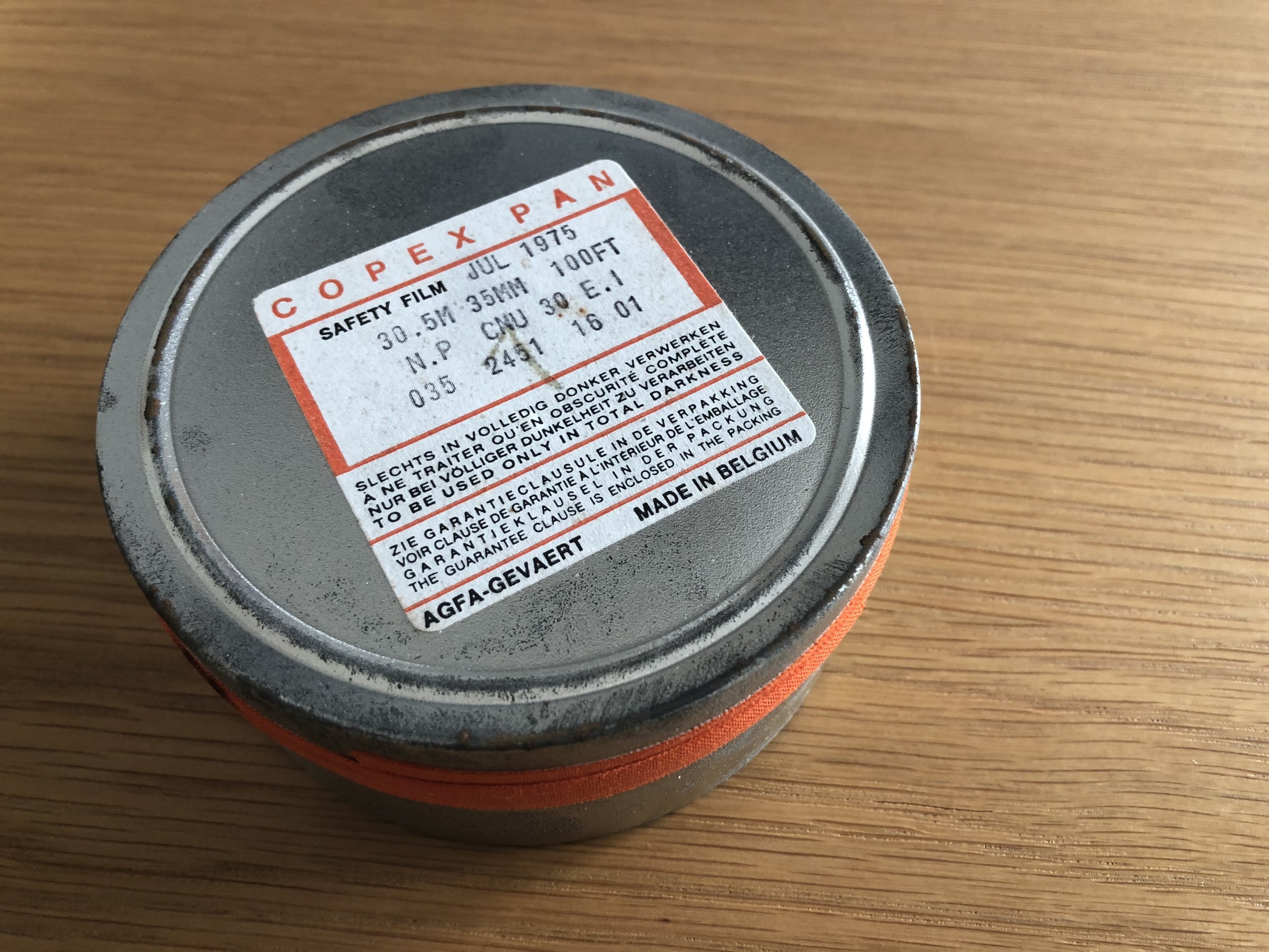

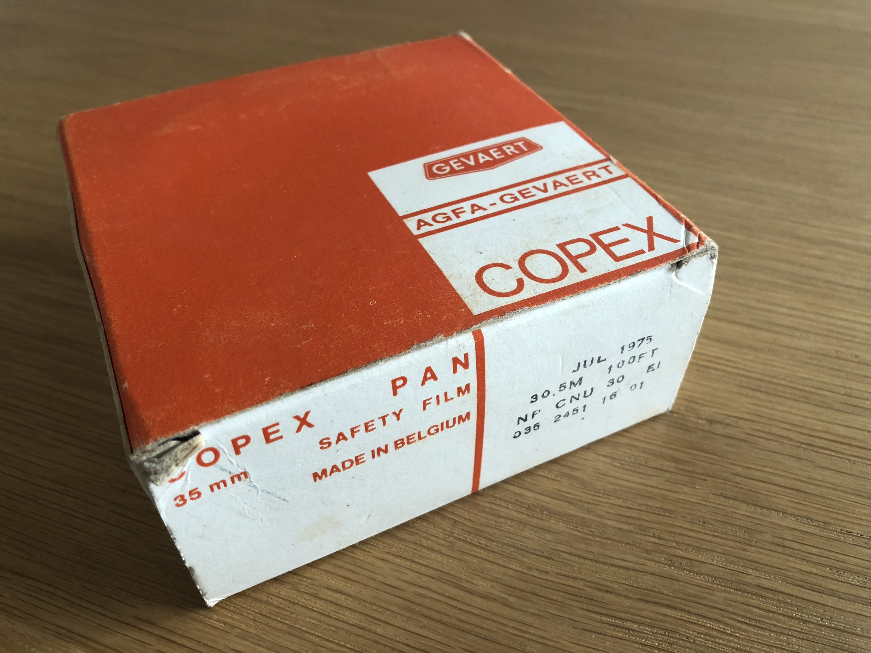

My dad just gave me eight rolls of Agfa-Gevaert Copex Pan from the 1970s (see pictures). He had recieved them when he was at school and kept them unused ever since. As the film does not have sprocket holes, I could only use it (more or less) in my 6x12 pinhole camera (or maybe in the Hasselblad using an adapter?).
Do I read the print correctly - is this film 800 ISO / 30 E.I.?
Do you think they are worth a try? How would you develop them? I've got Rodinal and Ilford DD-X developers at home. Or should I just keep them as a paperweight or something? :cool:

Better not Gregory:wink:!
.....because I you will expose this film at EI 30 you will not have the right fun with your photographs:pinch:!
E.I. on the box is. "1" I will repeat "E.I. = one" but it is obviously from the missing. "O".
Conclusions = E.I. 10 would be right if the film wouldn't have this expiration date.
So EI 3 - EI. 6 will come at it's best !
Was the term E.I. , Exposure Index already used around 1970 ??
Was the speed of such film stated on the box ??
I doubt both.

Indeed : Why we are talking of E.I. ? I can't remember - perhaps because OP asked about E.I. on the box.
I've looked again and can't find the mystique "one" = 1??? for a second time. What ever ISO 1 would be nonsense. But ISO 10 should be Ok....:wink:
So - OP your film should be marked with 10 ASA but we can't find that mark - glad to have the Name:
Agfa Copex - that's fine.
with regards:wink:
