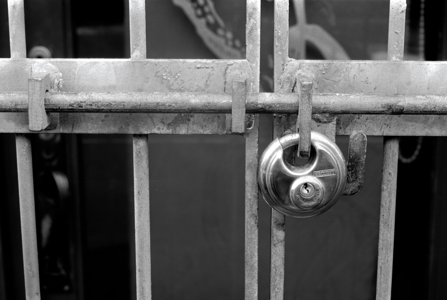

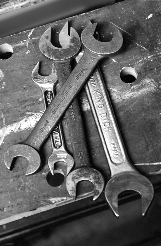

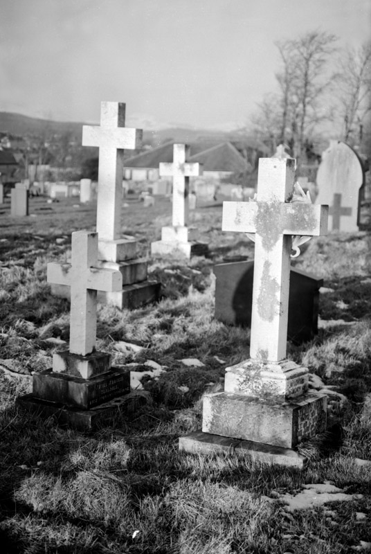

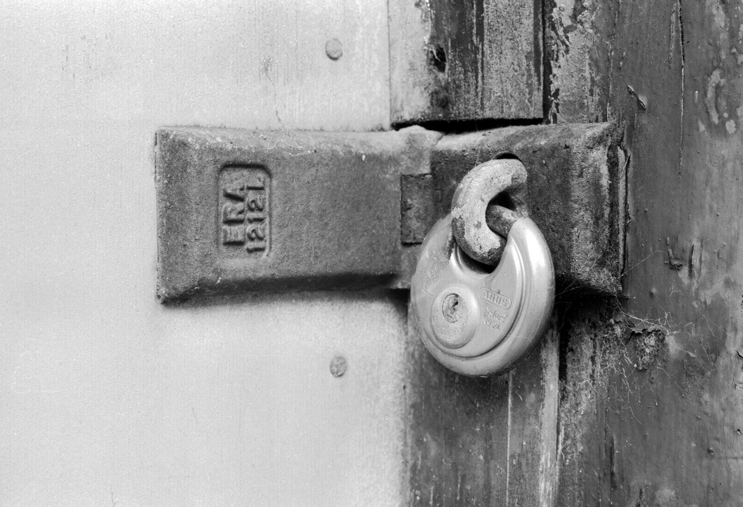

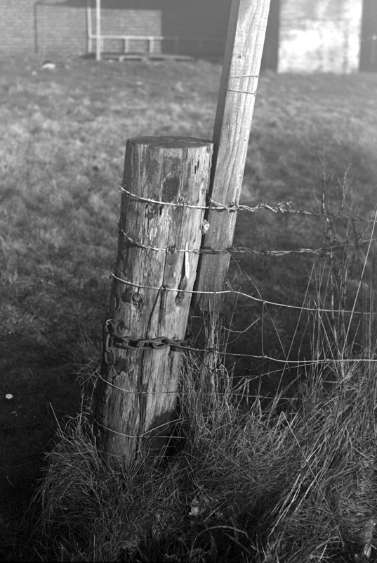

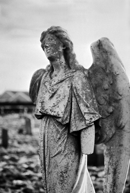

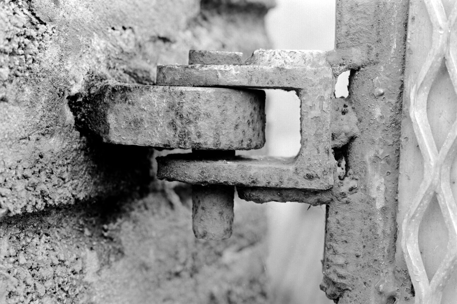

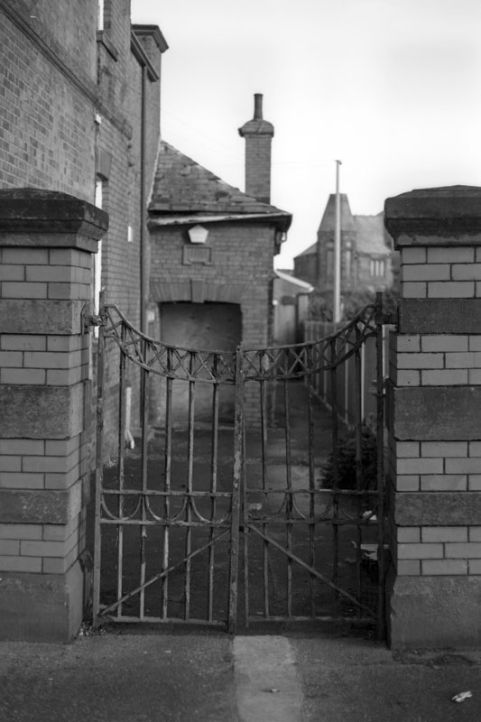

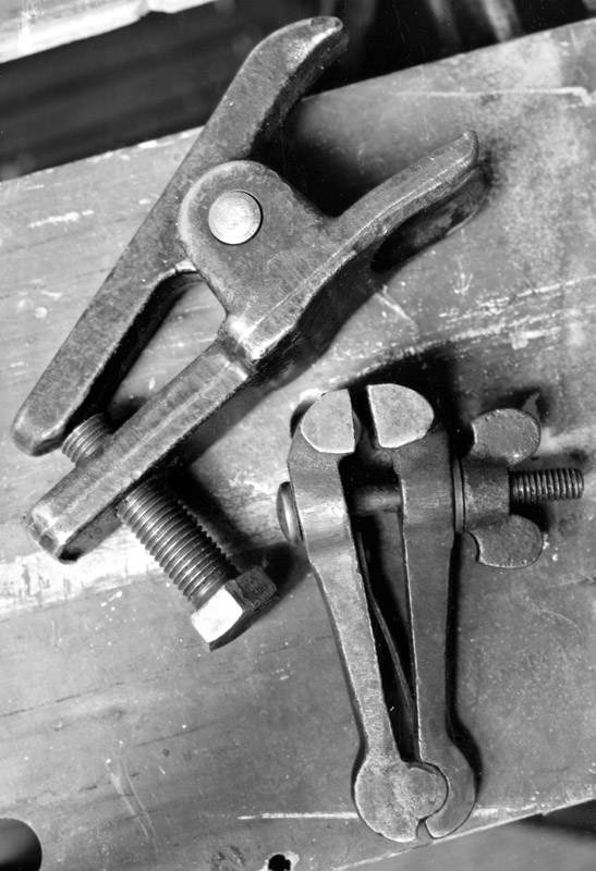

Hi folks
I bought a 30m roll of Agfa Copex HDP13 a while back dirt cheap and finally got round to trying it. It's unperf so the only camera I have that can use it is my EOS 10qd. I read that microfilm is great in bad light and as I like in the far north of England where the light is frequently bad, this interested me. I shot 8 rolls at ISOs 25, 50, 100, and developed in Microdol-X 1:3 to tame contrast. However, all my notes about dev times have proved to be useless as I discovered today the meter in my EOS 10qd was overexposing by about 8 stops, explains why I was getting such dense negatives. However, this film seems to have a massive latitude, and despite being extremely dense, my Plustek 7600i was able to scan them. All these are shot with my Micro-Nikkor 3.5/55, no point giving you specifics of development times and temps, but I think the dilute Microdol has done a good job of taming the contrast and producing nice tonality. Sharpness is excellent and grain is tiny, tonality is nice but I am sure I can improve on it now I've resolved the EOS metering issue.

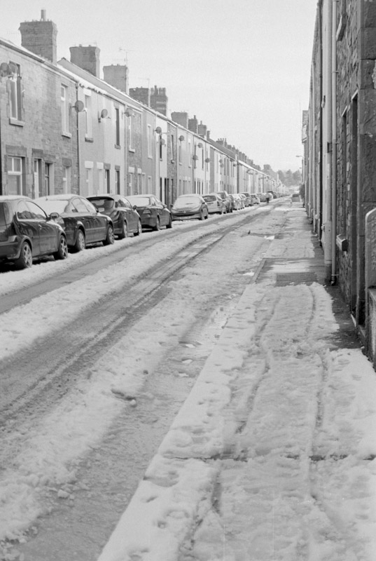

Hi Gorbas.
Thanks for the kind words. When I compared the meter reading of my EOS to a known accurate handheld meter, they disagreed by 8 stops. I varied the development with each roll, taking detailed notes, so as to find the ideal time. The film has incredible latitude, I got scannable negs when exposed at ISO 25 then developed for 30mins at 25C, and also when given the same exposure then developed for 10mins at 25C.
The film is a panchromatic (HDP= High Definition Pan) microfilm on a 1.3mil clear ESTAR base, speed is ISO 6 I think.
If you could see the negatives, they look like black rectangles, incredibly dense, I was amazed my scanner could even scan them. The best ones were a bit thinner. Now I know the camera meter was wrong, I can work around it, get the exposure right and nail the dev time to get close to ideal density, that should improve the tonality.
The light here at 56.4N in January is usually awful, for instance, the shot of the two tires was taken while it was snowing and just before sunset, really dark, exposure was 30secs at f8 with the film rated at ISO 100. I have tried shooting in similar light with 'normal' films like FP4 and HP5 and I get grainy poor results, so this microfilm is quite remarkable in it's ability to produce nice images in the worst light conditions. Conversely, in good light, it is very contrasty, so it is a film to be used on cloudy, dull days, which is a very important thing for me as here is is usually dull.

Those shots look very nice and contrast doesn't look bad at all. Pretty sharp, but certainly not as sharp as I've seen this film. It looks like it would be ideal for environmental portraits, but that's just my thinking. I have a roll of 120 CMS20, which is suppose to be the same, that I'm going to try shortly. I used to do Kodak Tech Pan in Rodinal 1:200 and it was very, very nice with extremely high detail. I'm going to go that route with the CMS20 and see what happens, but your Microdol-X results look fine too. JohnW
