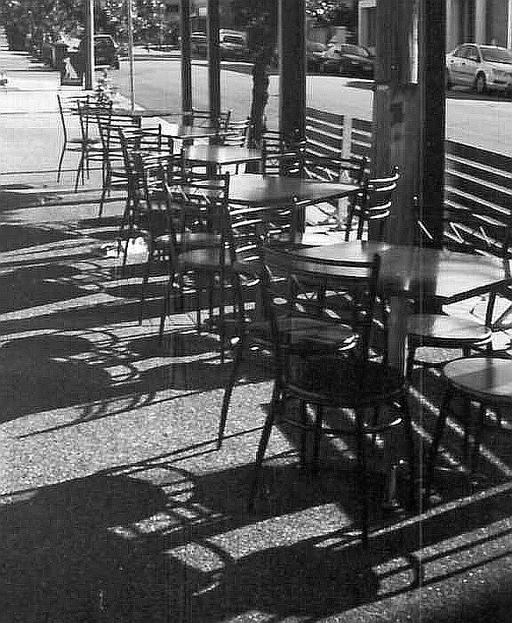

Spurred by a recent thread here on unperfed 35mm for use in 828 cameras, I bought a 100 ft roll of this, expired 2008. Initial results were quite disappointing. I rated at ISO 12, developed in DD-X (not sure what else to use). Took the development time down from 7 to 5 minutes looking to decrease contrast.
I would say most were way overexposed and unusable. Contrast was very high but in the less overexposed ones, there was potential there. But the strangest thing was that most were very blurry...which is the most puzzling aspect. The only thing I could think would be the film itself was not being held flat by the pressure plate, but I don't see how that is possible.
Could I have exposed the wrong side of the film? Anything? Anyone? :laugh:
I finally got it wind through the AE-1 by using scotch tape on the drive spool, though it left weird marks along the film, I can at least answer it's not blurry so to speak, it easily went over 100 lp/mm wide open on my Canon FD 28mm f/2.8
I had set the AE-1 meter to ISO 50, and processed for 14 minutes in H&W Control 1+16
If you view the full size image you can see it resolves the holes in the vent on the building which the entire vent has less width than a brick.

Again, looks like it has potential. Any thoughts on if you could print possibly these negatives. No way in hell could I print the any of the ones I had. Way too contrasty.

Looking at your photo samples you posted earlier, it might be that your camera pressure plate is off.

This looks and handles better at ISO 50 in H&W Control than Adox CMS 20 does at ISO 20 in Adotech II.
As far as I can tell the difference between Copex HDP 10 and 13 is the thickness of the film base. The one we have is pan sensitive as well as far as I can tell, I'm not sure if they are different emulsions or not. Also what we have is not Copex Rapid as far as I can tell as well. What we have should also be the same as current Kodak ImageLink HQ.
This what I'd expect a grade 2 straight print to look like, I also metered too much of the sky in my shot, I was just using the inbuilt AE-1 meter. Incident metering, or metering not including the sky in the frame would be better.
The base density is 0.26, this may be due to the marks caused by the tape, so normal base may be thinner. I measured a part of the sky, which is averaged altogether in one spot, but the densest reading I could get was 1.3.
It's more printable than CMS 20, and I do think it's workable at this speed.
