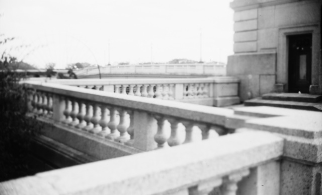

Microfilm is designed to be exposed in a machine under restricted light conditions. The blurry images that you are seeing may be the lack of anti-halation coating that is common. Lack of this coating causes the image to "bloom" when the film is used for pictorial purposes particularly when over-exposed.
Microfilms have very little exposure latitude, essentially none. So you must be spot on with exposure. Bracket all exposures.

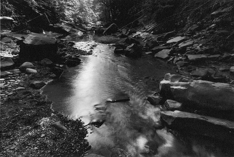

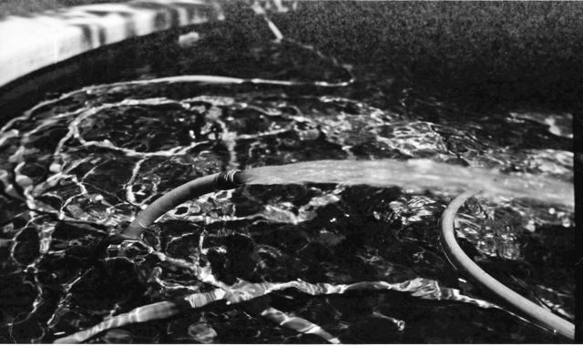

Attached are some examples
