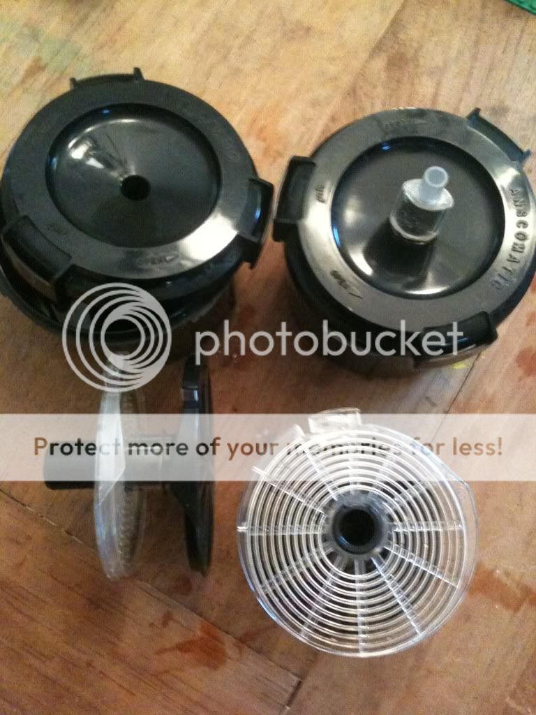

Hey Avi - when you mention the twirl method, are you referring to the GAF anscomatic:
Humm, I am not sure how one translates inversions to twirls, this kind of tank predates me and I am not sure if there are times that Agfa published back in the day for the GAF tanks.
Anyone got any tips?

Andy...yes...those are the very tanks and I believe I got them from you as a gift!:smile:
