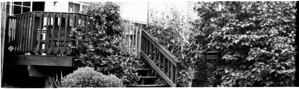

i tried it last night and it worked.
You could load the 35mm cassettes into a 120 camera such as a holga or folder such as an Agfa Isolette.
I have used 35mm in both with some success - gets a panoramic shot.
YouTube with instuctions on using 35mm in 120 camera . http://www.youtube.com/watch?v=AK9iBKoQYik
I put a 35mm cassette into my moskva-4 using a 120 spool for takeup - worked fine but i did get a mysterious scratch somehow. Here's a sample (bad subject and comp). This was Fuji HRII minicopy (iso 6 film) deved in diafine 3+3:
keithwms
Oct 14, 2006
6,220
Charlottesvi
Yes I do that now and then. Here is some ektar pulled through a mamiya 6:
http://keithwilliamsphoto.net/dejarnette/content/dejarnette0409003_large.html
RE: the scratch, do you mean that scratch 1/3 up from the bottom? That will probably be a dust particle somewhere on the emulsion side of where the film goes across the exposure area. Just blow out the camera well, be sure all dust is gone. Also be sure that there aren't any scratchmakers on the pressure plate.
