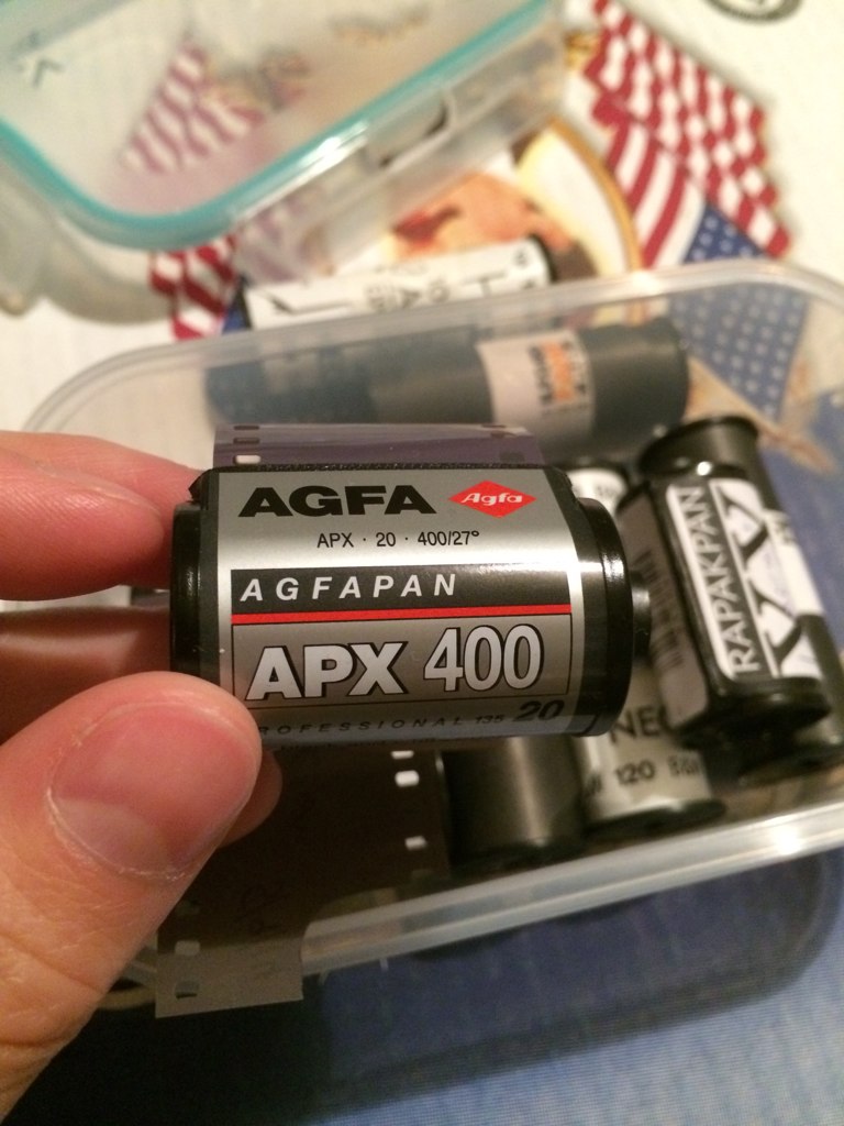

Hey guys, I have this old role of APX400 it's the original kind, i'm not entirely sure that the emulsion has changed from the old-style, but it's definitely the old version before Agfa shut down.
I got this back in 2001 when I was in high school, the yearbook had switched to digital and my teacher knew that I was into photography and gave me several rolls of it.
I shut everything except this last roll years ago, and came across it a few years back and have been holding onto it and recently decided to shoot it.
When I looked up the times with the massive Dev chart app, it didn't seem to give a 400 speed developing data using Rodinal 1:50.
Upon further research, I found the original data sheet which says that if you're developing 1:25 it's 10 minutes and 1:50 is 30!! This seems like an extremely long developing time, when all the other developing times seem to be fairly normal in the 9 to 11 range, so why in particular is Rodinal all at a dilution of 1:50 such a long development?
I wanted to process this this evening with some of my other films, I'm not going to devote 30 minutes using Rodinal and my only other developers on hand are DD-X, and I may possibly have just a little bit of Ilfsol-3 left over.
It just seems like a very long time, I mean, HP5+ shot at 3200 times are something like 30 minutes... But this was shot at box speed. What's the deal?
Thanks oh knowledgeable bearded ones...
