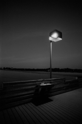

I will be posting pictures whenever I have some time to print, but looking at my negatives, I report some pretty good results with this developer.

I used Agfa 72 at 1+19 on FP4+ for 8 min, and got excellent-looking negatives, with good midtones. The stock solution looks murky and heterogeneous, but give it a good shake, dilute, and it's looking normal.
These simple glycin developers seem to have the property to enhance midtones, so they may give a flat result on films that do not have a lot of inherent contrast. For instance, HP5+ gives a very even negative, and you need to do some darkroom work to get your deep shadows and your bright highlights. As always, this might be a tool in the right hands.
The image is nicely sharp and the grain is unobstrusive.
